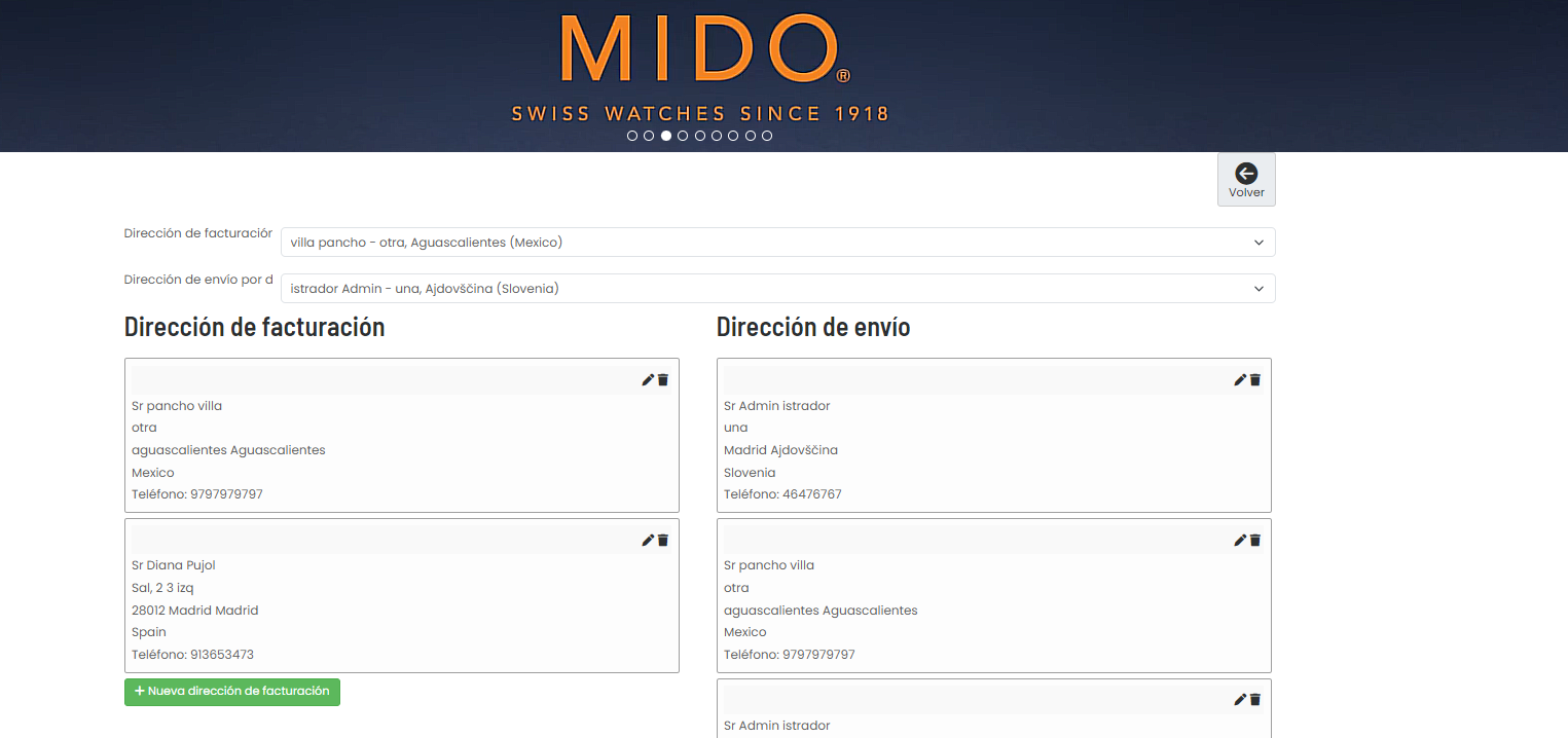

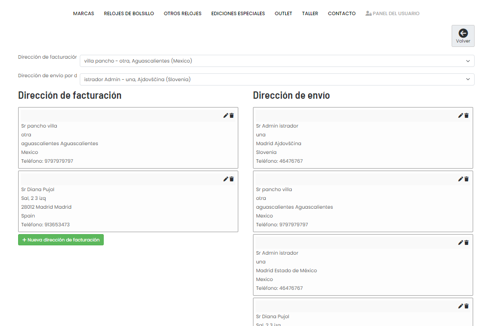

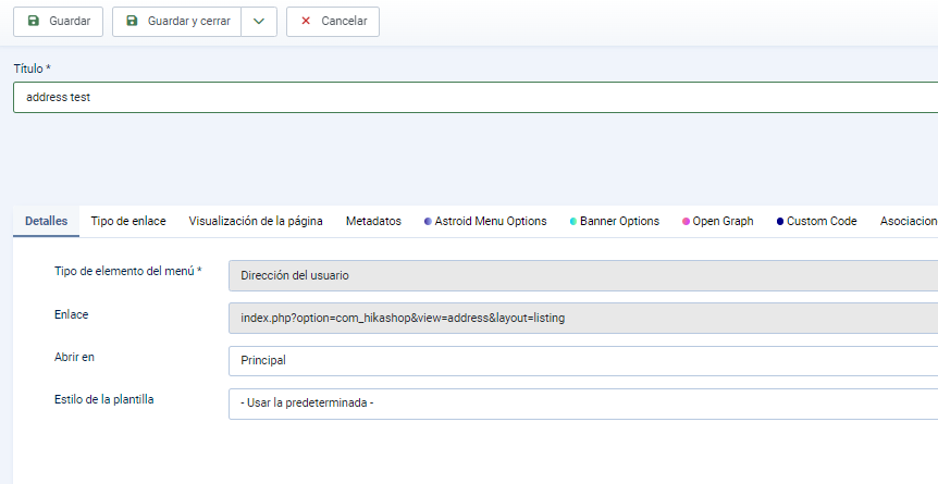

I have created the menu element again (see image)
I have clicked in it and the page is the home template (yo can see the banner over the addressess) and the return button. The URL is component/hikashop/view-address/layout-listing
I have clicked on addressess from the cpanel (another template). The URL is panel-del-usuario/panel-del-usuario/address
And I don´t have any idea of how to fix it
Thank you
