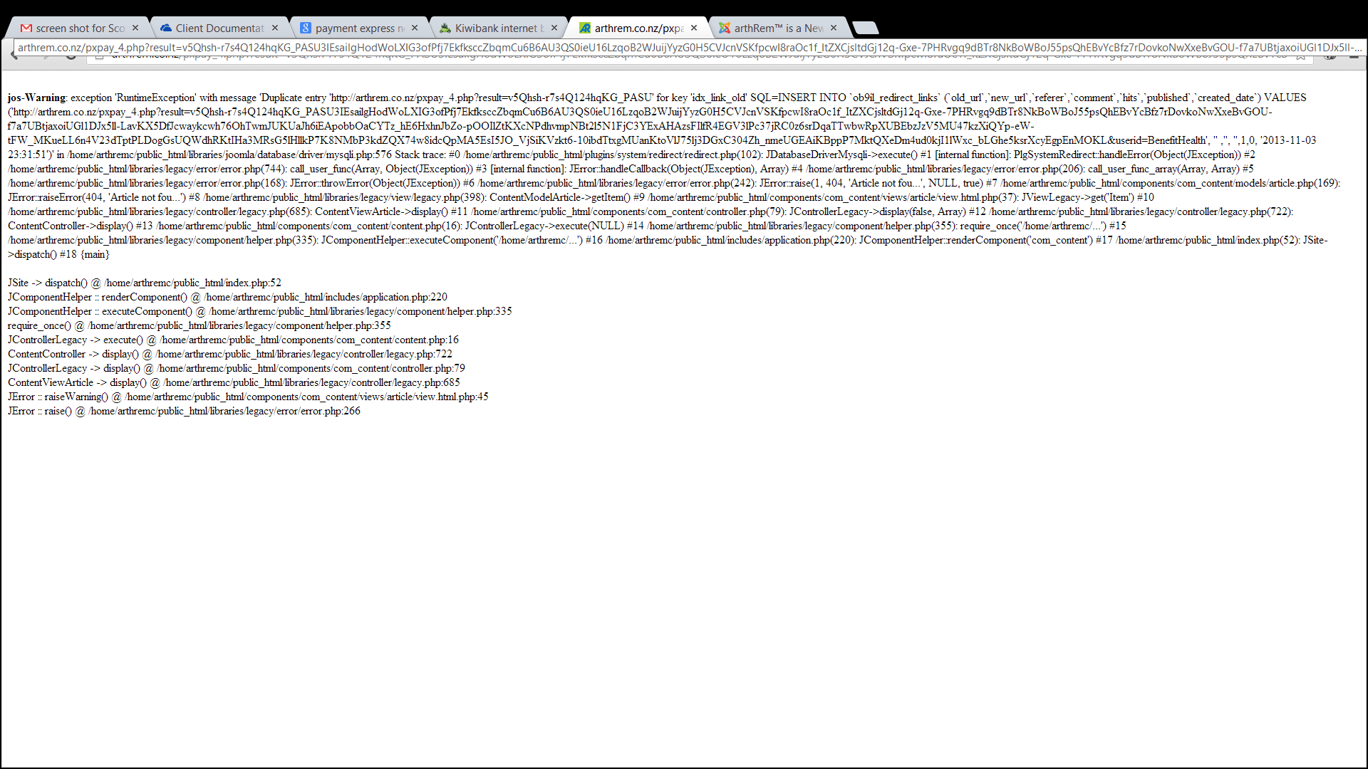

When people are using the PaymentExpress plug-in you developed for us it is causing a warning message and the payment is not being received.
It has been working fine for several months. This problem just occurred with the 2.2.2 update.
From client:
"Spoke to Payment Express and they think it is something from the websites end. The screen is popping up that the payment has been approved, but its the next step that it is falling over. Here is the screenshot of what is coming up. We are not receiving notice that the PXPAYMENT is going through. "
See screenshot.

This looks like an error from the "redirect" plugin of joomla which is called on a joomla article page. So probably the display of the URL you entered in the "return URL" parameter of the plugin.
It doesn't look like an error in HikaShop either but more a bug of the joomla redirect plugin.
Please note that we do not keep user accesses so I couldn't check your backend, but I would recommend to try to deactivate that plugin to see if that helps, and see if you have a return URL configured in the plugin and if so, is the page displayed on that URL correct.
