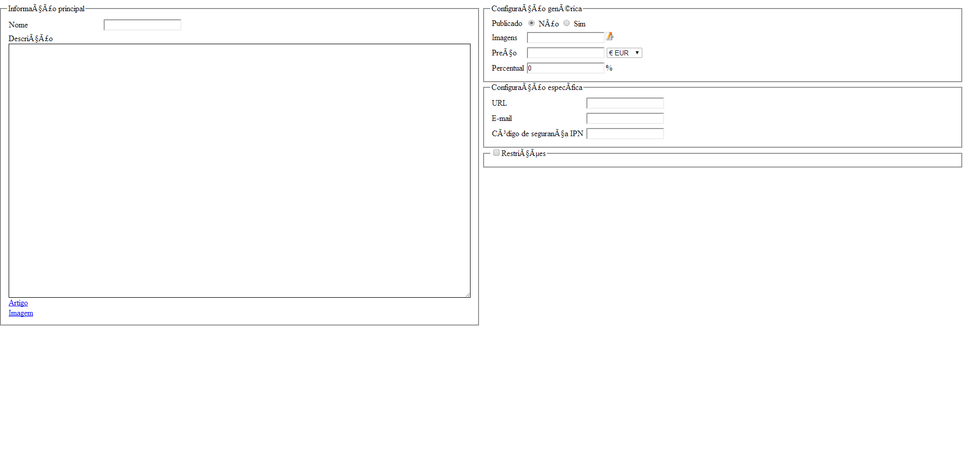

12 years 8 months ago #138998
I did exactly as you said, but the plugin configuration page stay the way as on print-screen attached. What is wrong? The font of plugin is also attached, please help!

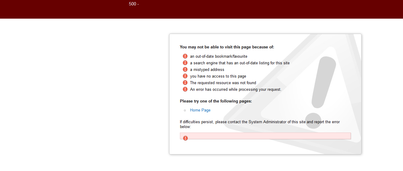

12 years 8 months ago #139116
Forget my last message, i have created other plugin based other payment plugin and that error is no more.
But my new plugin get a error 500 on the step2, after finish order (the payment's library create a external link), like printscreen attached. Do you have any idea why this error?

  • Posts: 86179
  • Thank you received: 14214
12 years 8 months ago #139126
A 500 error doesn't say anything about the problem. It could be anything.
Look in your server's PHP error log for the Fatal error behind that 500 error and you will know where it's coming from and why.
  • Posts: 25
12 years 8 months ago #139260
The log is empty, no error:
"POST /fechar-pedido/finalizacao/step-1/task-step HTTP/1.1" 500 1434
Only it.
The error show when i set a variable inside setSender:
        $nome = $order->customer->name;
   	$email = $order->customer->email;
        $paymentRequest->setSender(
            $nome,
            $email
       // error
if i set hardcode on the setSender, no problem is showed:
            "Nome Maldito",
            "plugin@maldito.com"
       // no error
Why ? I do not understand why, do you have any ideia ?
update: I discovery the error: the payment library has some kind of parse about customer name... i just check if the name is right before send across method...
update 2: i made the plugin, all is working without problem.
