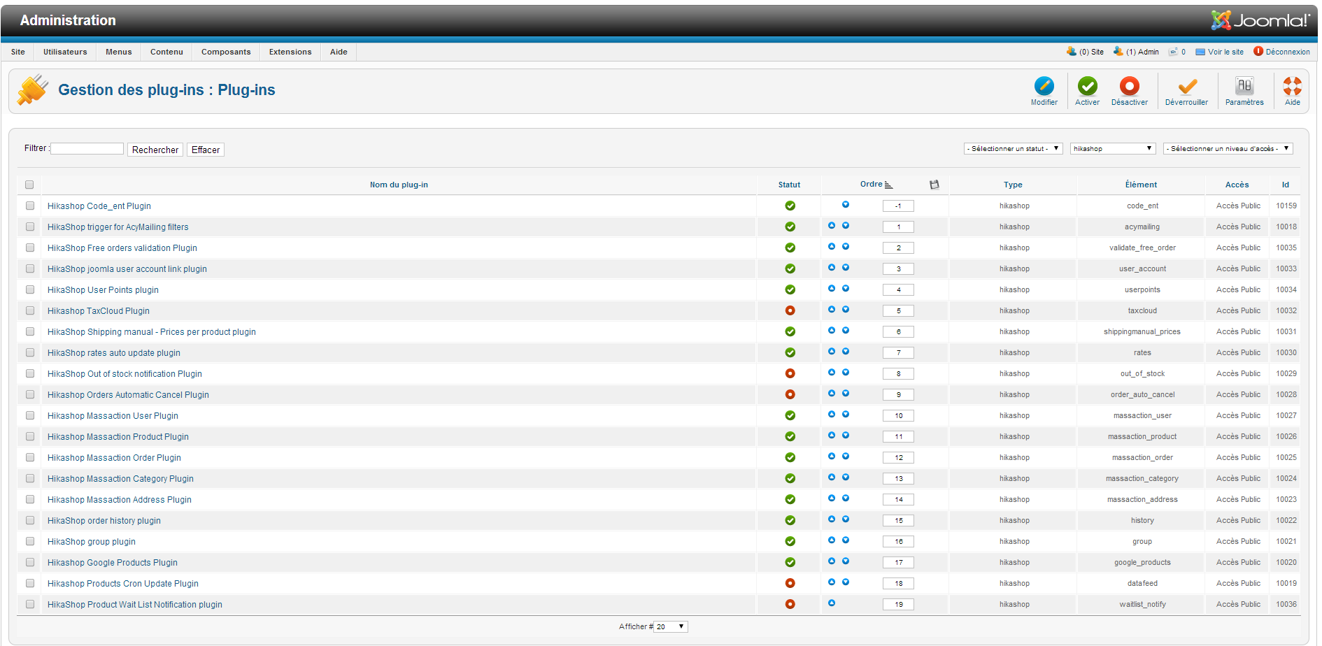

12 years 4 months ago #154059
So, i've ordered the plugin code_ent with a negative value (see my first screen image).
But no success : always the error
NULL NULL Notice: Trying to get property of non-object in /var/www/vhosts/fair-play.fr/subdomains/cerise/httpdocs/plugins/hikashop/code_ent/code_ent.php on line 34 string(1) "0" Notice: Trying to get property of non-object in /var/www/vhosts/fair-play.fr/subdomains/cerise/httpdocs/plugins/hikashop/code_ent/code_ent.php on line 45

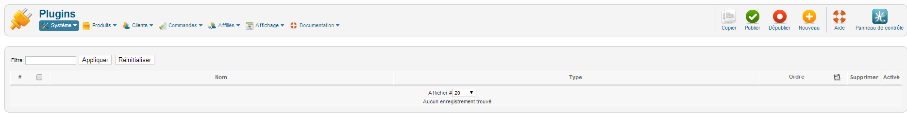

I wonder if it is normal that the lists of plugin on Hikashop is empty ? (see my second creen image)
Best Regards
12 years 4 months ago #154118
Could you give us the corresponding code for the lines "34" and "45" just to be sure of which variable is not an object ?
In HikaShop plugins, you have to click on new in order to enable plugins presents in HikaShop but not enabled by default.
So having nothing in this listing is not a problem.

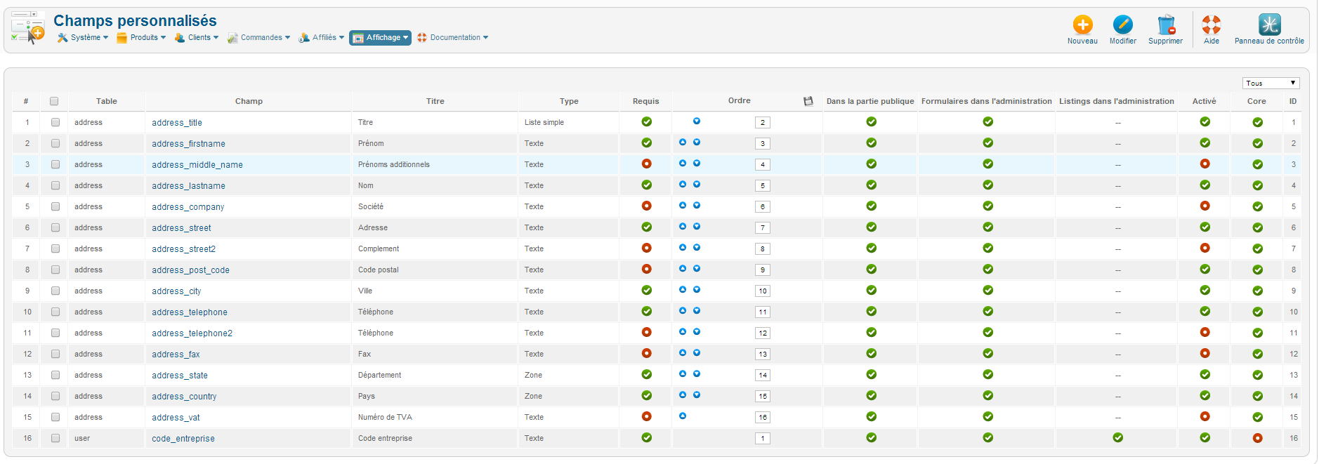

And are you sure that the Column name of your custom field "Code entreprise" in the user table is "code_entreprise" and not, by default, "codeentreprise" ?
