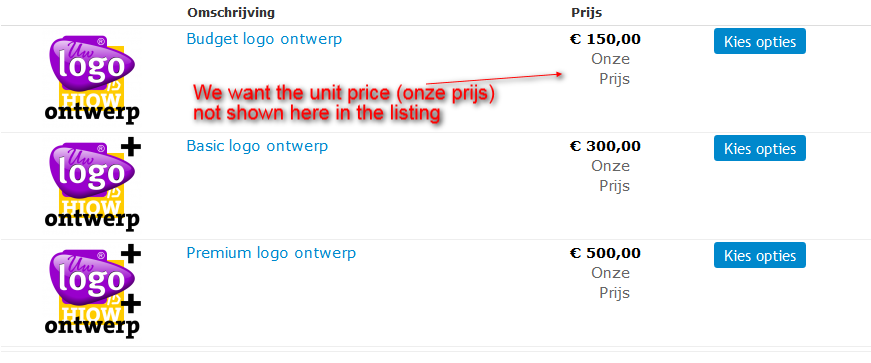

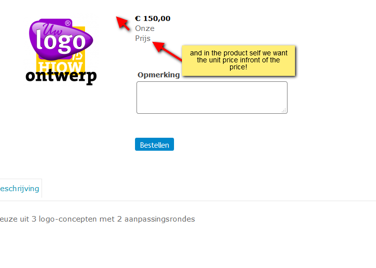

We want the line price per unit. before the price instead of behind. but not to be shown in the listing of products.
can u tell me how to do that! i attached two images one of the products listing and one of a product itself.
I can not seem to figure it out. Please help.
Thanks.

1. we don't want to remove the price in the listing. only the text price per unit.
we alterd the table that's why the text price per unit is now underneat the price. normaly it will be after the price. like this: $ 40,- per unit.
2. in the product itself we want this textline per unit (we will translate this text in dutch to: onze prijs) to be before $ 40,-
so that it looks like: onze prijs $ 40,- instead of $ 40,- onze prijs

11 years 5 months ago #195535
So to in the view "product / listing_price" you can replace the code:
			if(isset($price->price_min_quantity) && empty($this->cart_product_price) && $this->params->get('per_unit',1)){
				if($price->price_min_quantity>1){
					echo '<span class="hikashop_product_price_per_unit_x">'.JText::sprintf('PER_UNIT_AT_LEAST_X_BOUGHT',$price->price_min_quantity).'</span>';
				}else{
					echo '<span class="hikashop_product_price_per_unit">'.JText::_('PER_UNIT').'</span>';
By:
			if(JRequest::getCmd('layout') == 'show' && isset($price->price_min_quantity) && empty($this->cart_product_price) && $this->params->get('per_unit',1)){
				}else{
To display it only on the product detail page, and move that whole code earlier in the view to display it before the price.
