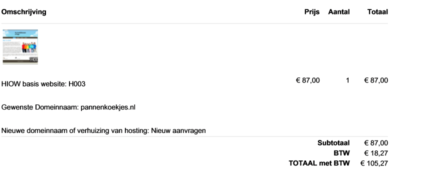

let me try to explain..
in the order confirmation, see image: confirmationimage.png u see under Omschrijving the name of the product / variant.
Product is HIOW Basis Website "Variant" is H003
When a customer have ordered this product it will go to our accounting system via soap call to there api ..
But on the invoice created by the accounting we get the following.. see pdf file, this is an order of the product then with variant H001
HIOW basis website<span class="hikashop_product_variant_subname">: H001</span> H001
The data for this we call directly from the database and that is from the hikashop_order table the row order_product_name. The <span class is also in the database.. and we would like to get this out so both the order confirmation mail and the invoice will look neatly.

As Jerome explained, it's normal that you have the HTML tag <span class="hikashop_product_variant_subname">: H001</span> in the order_product_name of the database.
You should leave it like that. Instead, when you generate the PDF, you should add a strip_tags on the order_product_name you're using so that it would remove it during the generation of the PDF. That's what HikaShop does when it generates the invoice from the backend of HikaShop, or sends the name of the product to payment gateways, etc.
Now if you really want to remove it from the database field, you can alsways hack the code of HikaShop to do it by changing the line:
$orderProduct->order_product_name = $product->product_name;
to:
$orderProduct->order_product_name = strip_tags($product->product_name);
in the file components/com_hikashop/controllers/checkout.php but I don't recommend it and rather recommend it doing it when displaying the information in the invoice.
