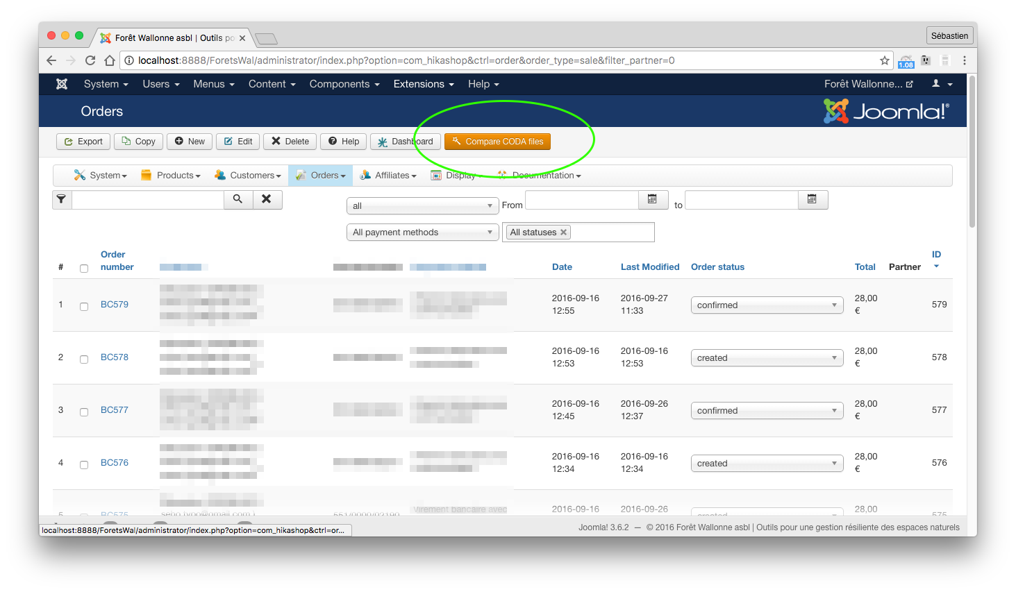

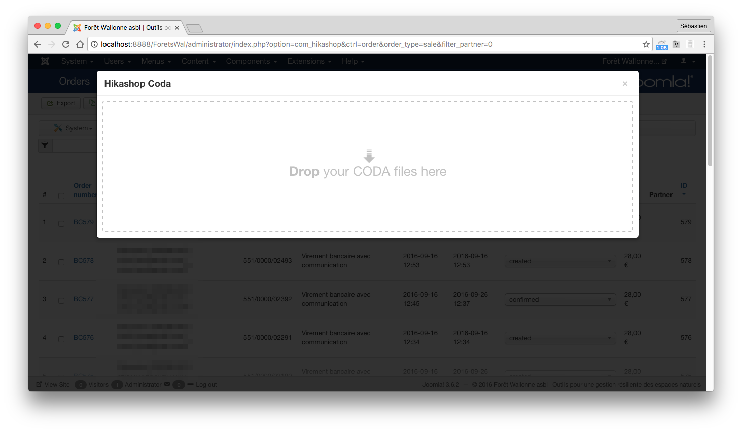

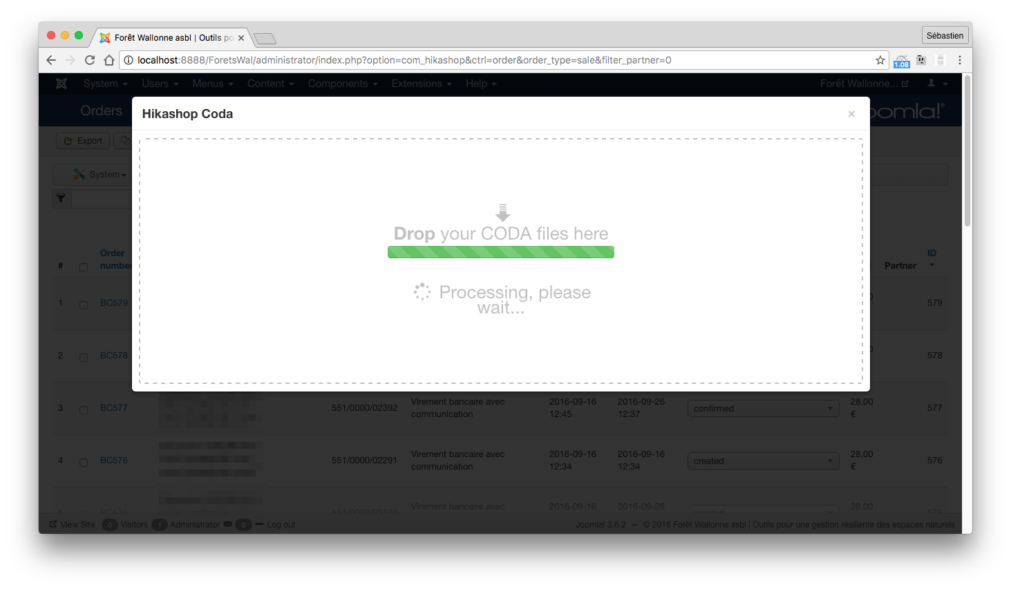

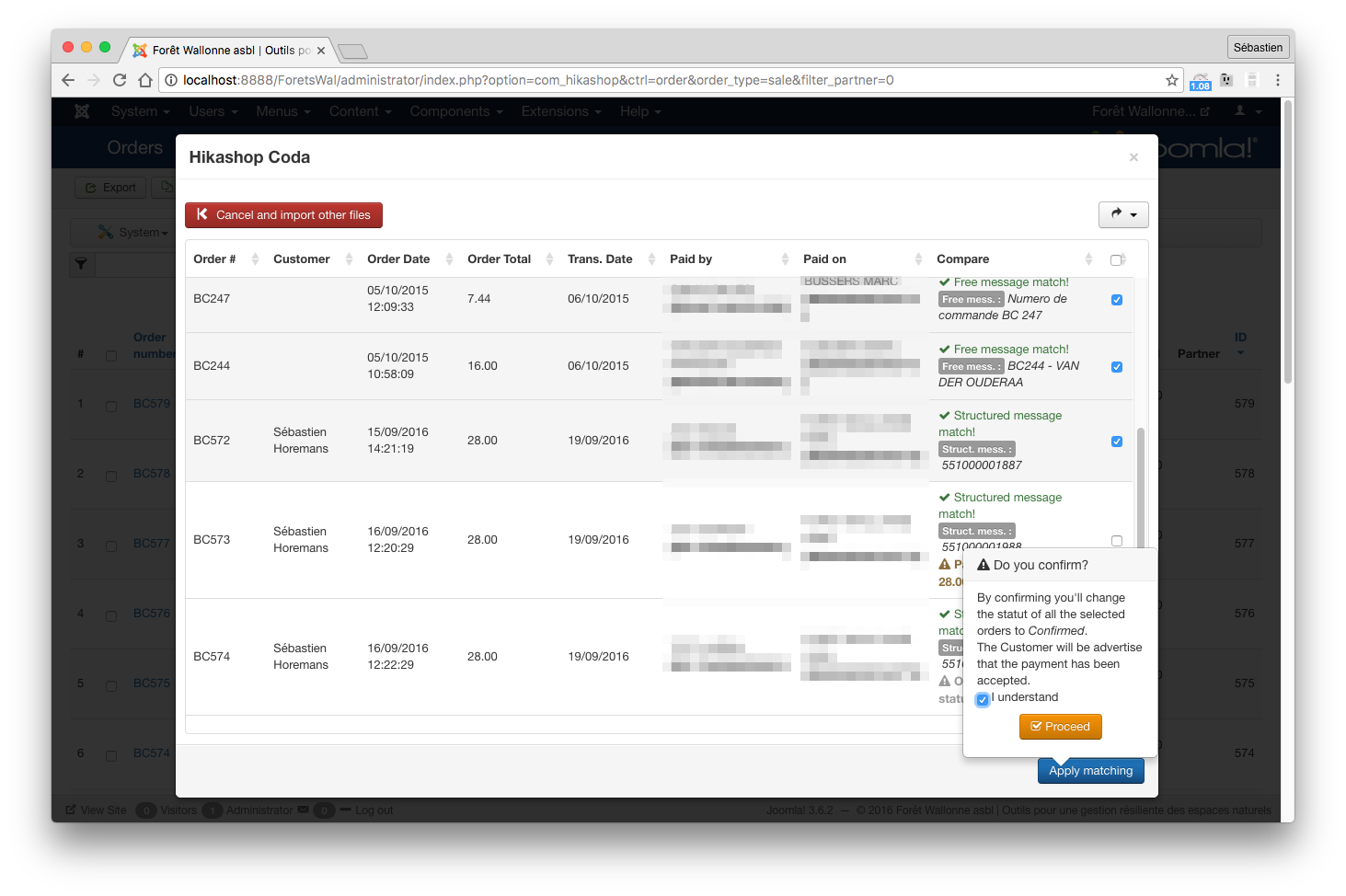

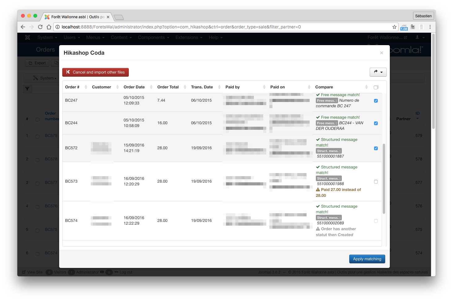

I put some screenshot of my dev for information on attachment
