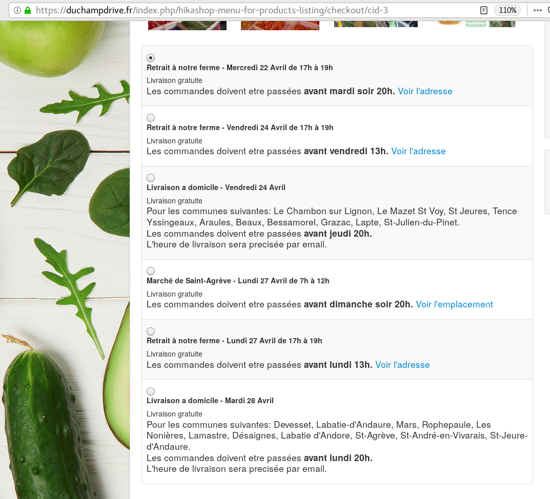

Thank you for your reply.
You can find the shipping options at:
duchampdrive.fr/index.php/horaire-de-retrait-livraison
You can see they are day dependent and they will change continuously over the year. Right now, I have input them as text in an article.
If you do the checkout, you will get the attached options at the shipping stage, that I have input in hikashop/shipping. I would like the attached page to be in displayed at: duchampdrive.fr/index.php/horaire-de-retrait-livraison
Do you think it is possible?
Thank you
Martial
