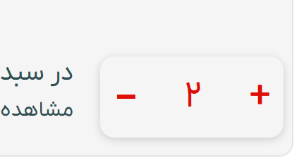

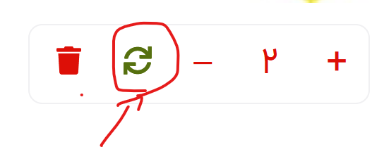

  • Posts: 47
2 years 3 months ago #361233
I turned it on before and in product detail pages it works fine but in the cart display and also in the checkout section it doesn't work, see the attach, please.

  • Posts: 86178
  • Thank you received: 14214
2 years 3 months ago #361234
The - and + buttons on the cart and checkout pages are already in auto refresh, without doing anything, on my end.
It's the default behavior of HikaShop.
Could you provide the URL of the shop and instructions to see these pages?
Could you try to temporarily switch to the default template of Joomla in order to see if you have the problem with it too ?
The issue might come from old view overrides in your template.
