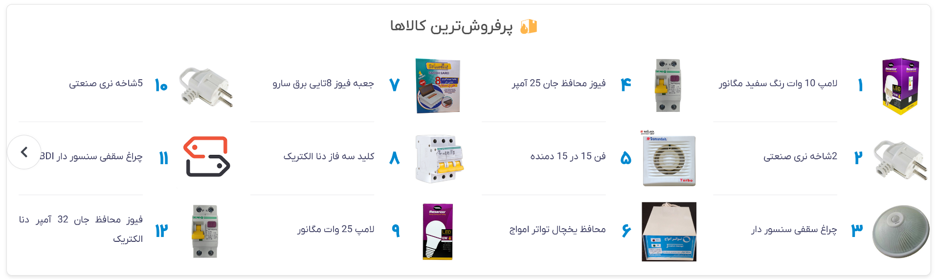

when opening a product through the category listing, everything seems ok, I mean the breadcrumbs display a complete path to the top category and on the product's page there is no module with a module position in the product's top area but when I use the HikaShop Content Module and open a product though the module, breadcrumbs just display "Home/'Product name'" and in the top area of product page I have unwanted module with module position,

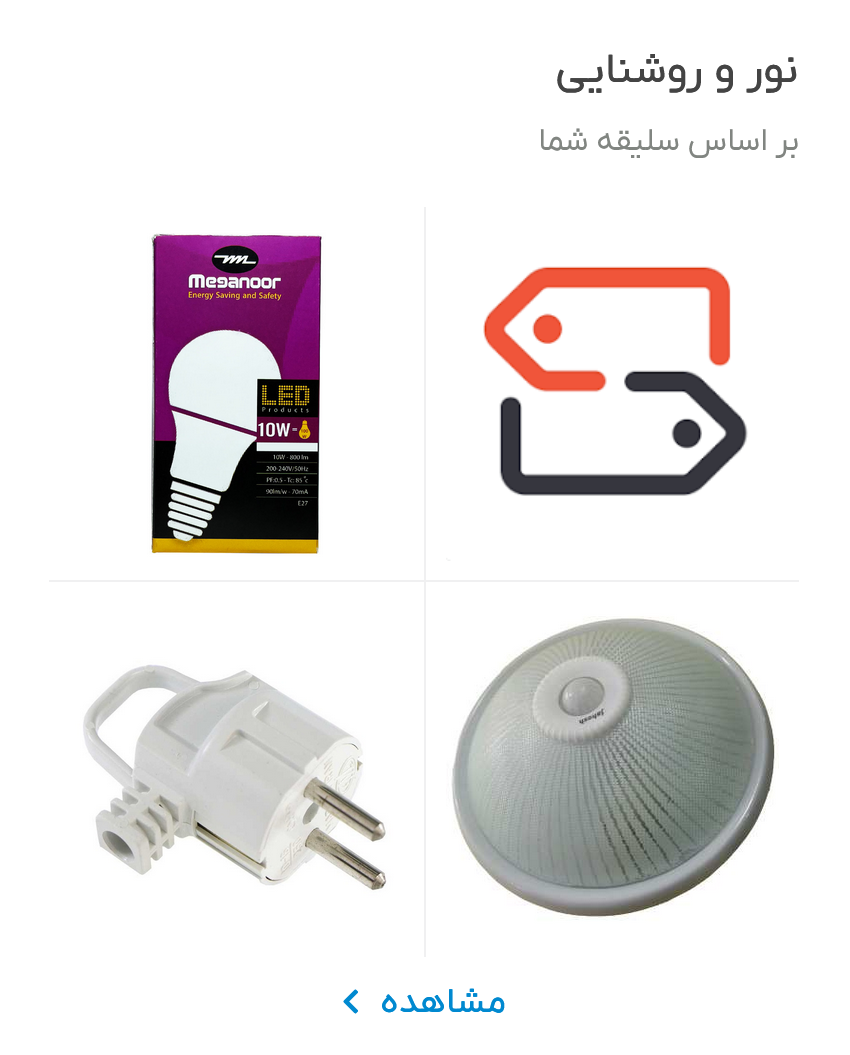

I designed two modules for Hikashop with a custom layout, but I can't add a menu option to them to fix the breadcrumbs issue, is it possible to send them and help me with them?

here are both modules:
mod_hikashop_2x2productdisplayRev02:
mod_hikashop_category_products-Rev02
Thanks in advance
