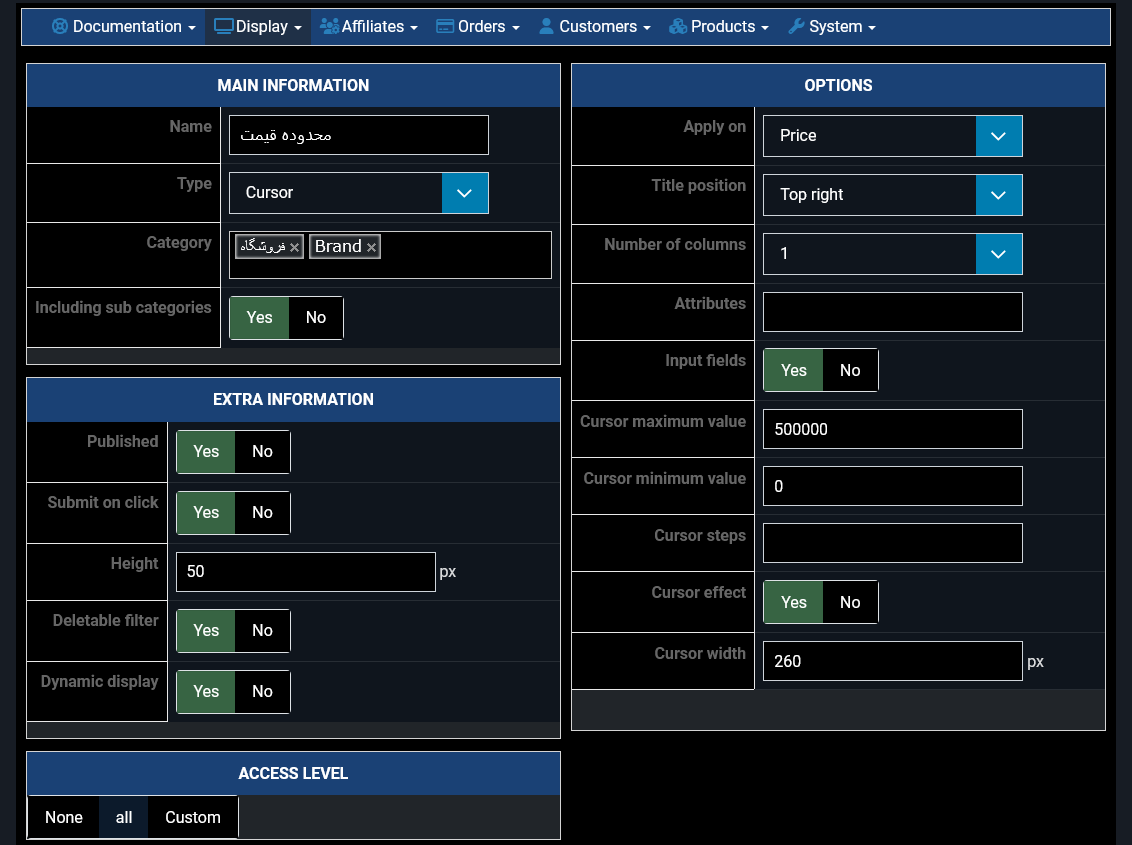

I use the filter and assign Price a filter,
admin area:

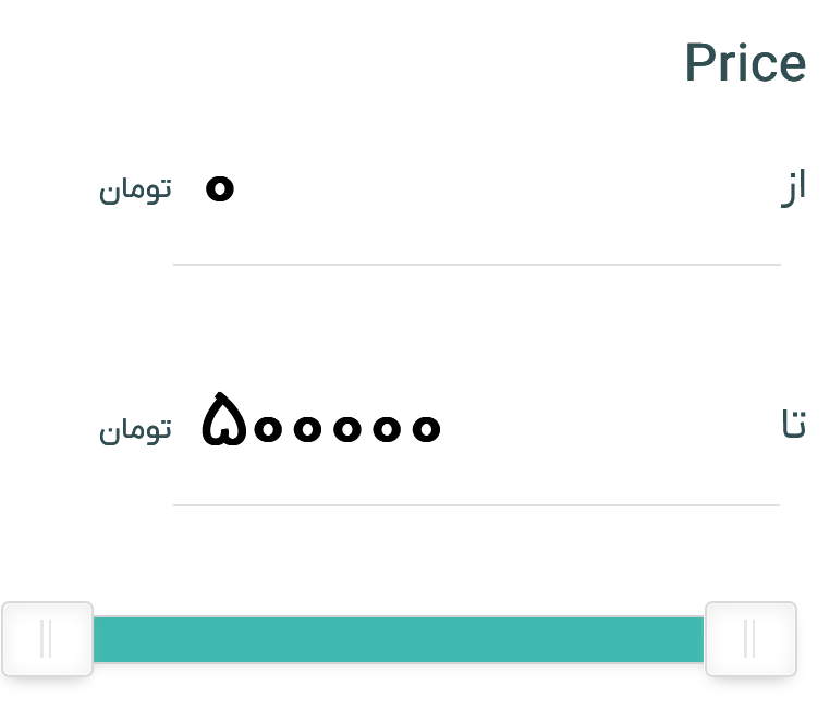

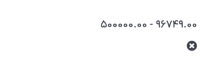

The issue is when the filter is activated, the filter title will disappear and nothing will be displayed as the filter title;
What can I do to not hide the filter title when it is activated?
Also, I need the style to remain as when it was inactive, because when it is activated, the style changes, and the currency title will disappear too.
and is it possible to separate number value as 1000 separation? for example, 1650258$ turn into 1,650,258.
Thanks in advanced

You want to turn off the "deletable filter" setting.
You might also want to turn off the "dynamic display" setting of the filter.

Great! With disabling the "Deletable filter" it got OK! Thanks

I suppose that you're talking about the price in the input fields. That's because it's an input field. Turn off the "input fields" setting of the filter and the tooltips of the filter will have the prices with the separators like everywhere else. For the input fields, it's not possible to have the separators.
