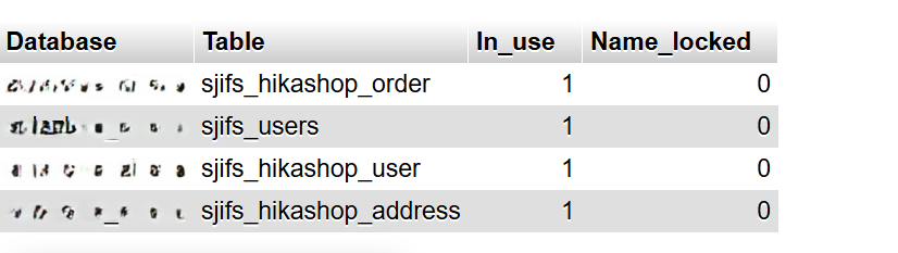

  • Posts: 431
  • Thank you received: 22
1 year 4 months ago #367059
The database just stopped for a while again. It's difficult because I don't have all the data about the sql logs on the server.
This is all I have in joomla logs:
PHP ​​Fatal error: Allowed memory size of 1073741824 bytes exhausted (tried to allocate 56623120 bytes) in /public_html/administrator/components/com_hikashop/helpers/spreadsheet.php on line 192
PHP Warning: Undefined property: stdClass::$massaction_name in /public_html/plugins/actionlog/hikashop/hikashop.php on line 578
PHP Warning: Undefined property: stdClass::$massaction_name in /public_html/plugins/actionlog/hikashop/hikashop.php on line 589
PHP Warning: Undefined variable $customer_num_uses in /public_html/administrator/components/com_awocoupon/awocoupon/library/class-awocoupon-library-discount.php on line 5597
When checking database with query SHOW OPEN TABLES WHERE In_use > 0;
I get some lock tables.
  • Posts: 86178
  • Thank you received: 14214
1 year 4 months ago #367060
We might be onto something here.
The fatal error in your PHP error log indicates that an export run and failed because it tried to load more than 1GB of data in memory from the database. And this means that the MySQL server must have run for a while to process all the data generated by the export MySQL query before sending all that data to PHP. And while this happens, the order and user tables will be locked so that the data doesn't change while MySQL process and retrieves all the data from these tables to generate the export file.
If that export is made with a mass action and runs periodically (like every hour, or more), it could well be the reason why your tables get locked after a while and then the database becomes unresponsive as it's trying to process too much export data.
So, I would recommend checking your mass actions first and see if you have any order export mass action. If so, try disabling it (or them if you have several of them) and see if that helps.

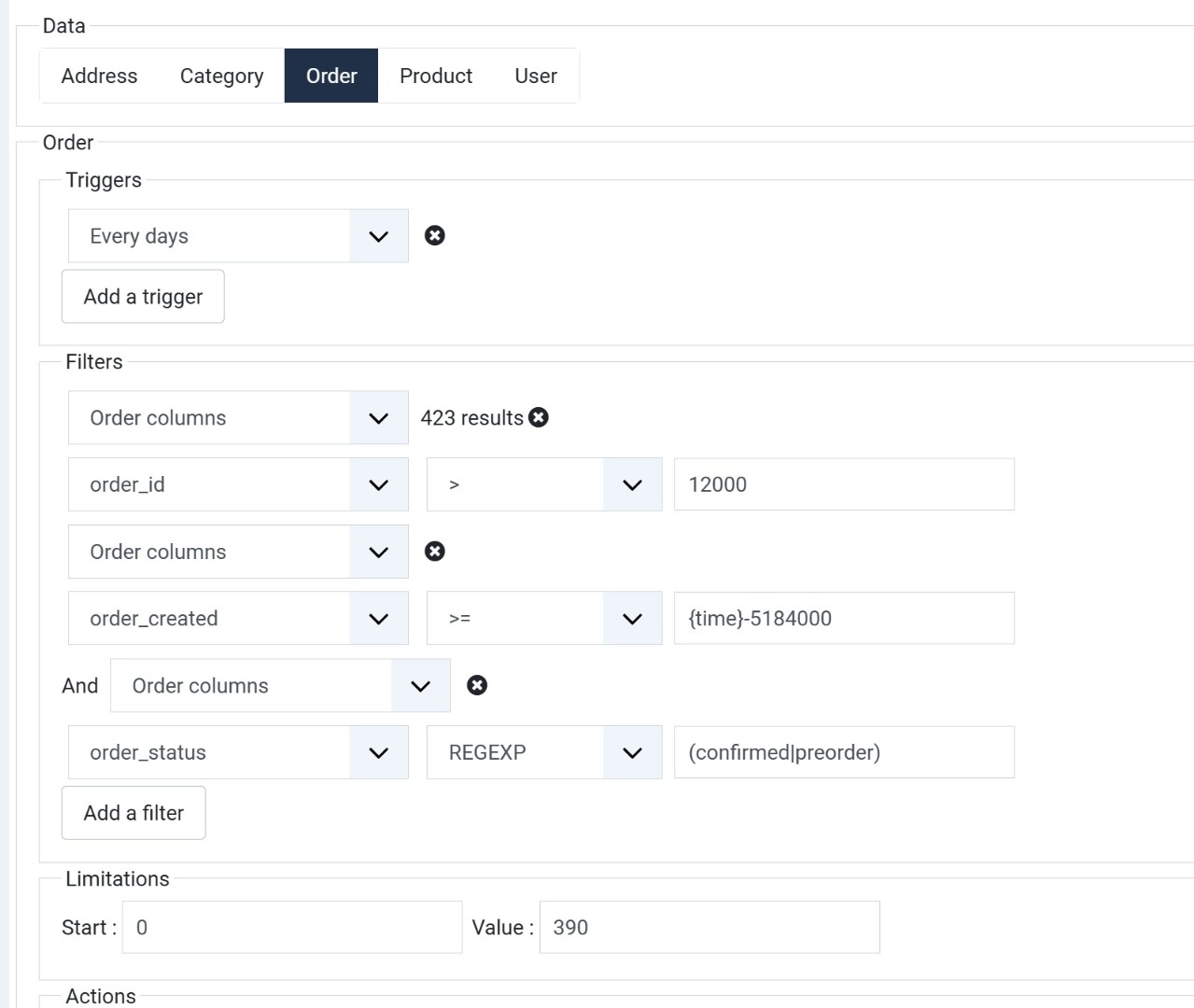

  • Posts: 431
1 year 4 months ago #367061
Yes, I have that mass action. I export daily orders in xls file. I need this for CRM import.
But that worked for years now and no problem.
  • Posts: 86178
1 year 4 months ago #367062
Seeing the number of results for the first filter (423) this can't be what is generating the problem. The mass action should only need a few dozen of MB maximum of memory, nowhere near the 1 GB limit.
So the error was generated by something else.
