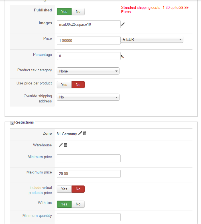

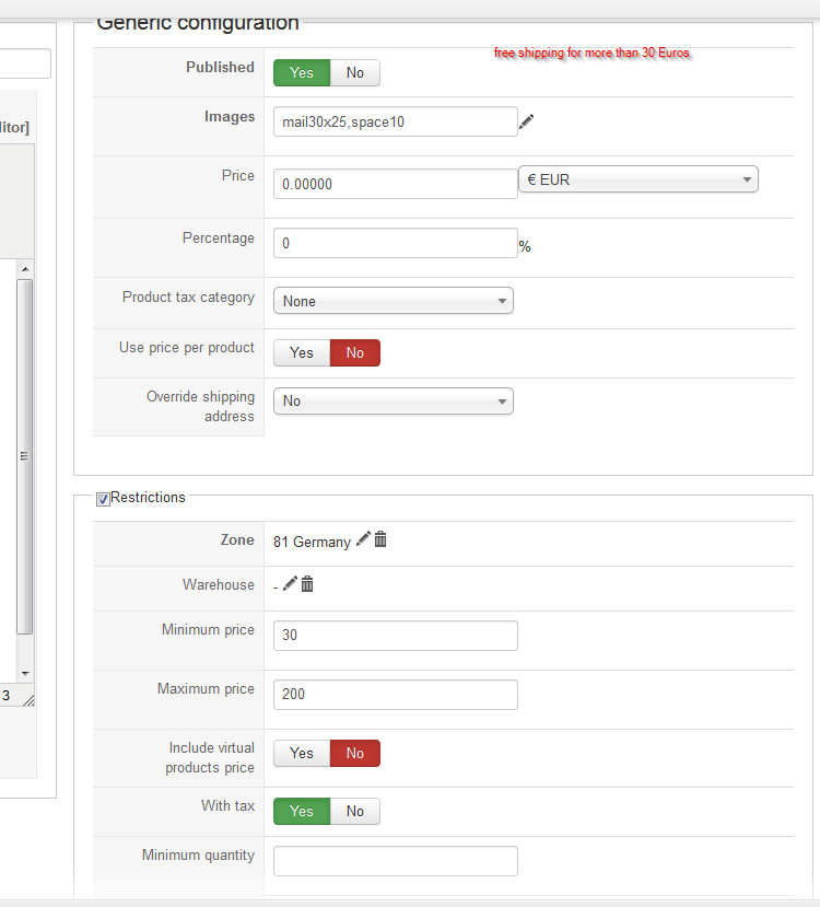

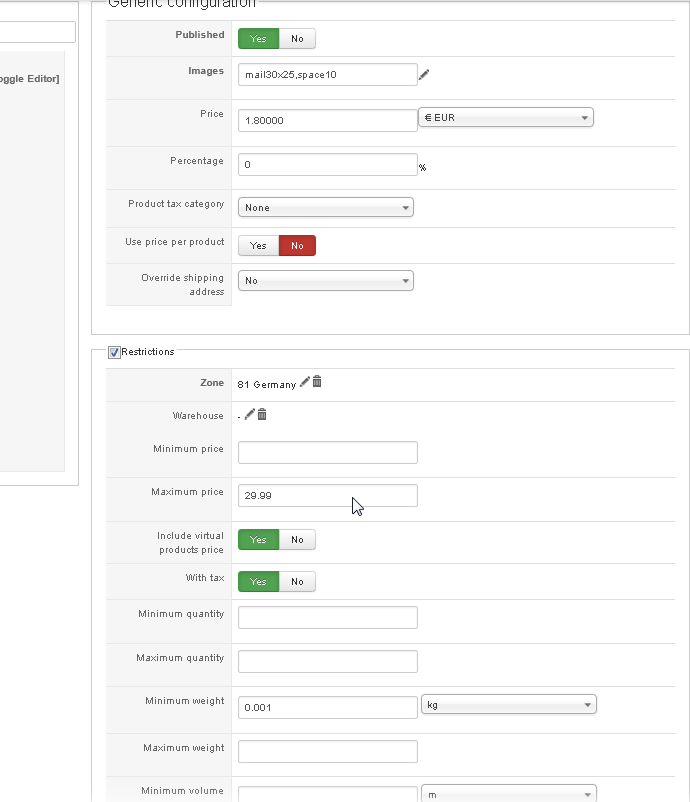

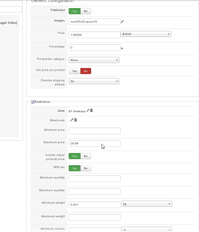

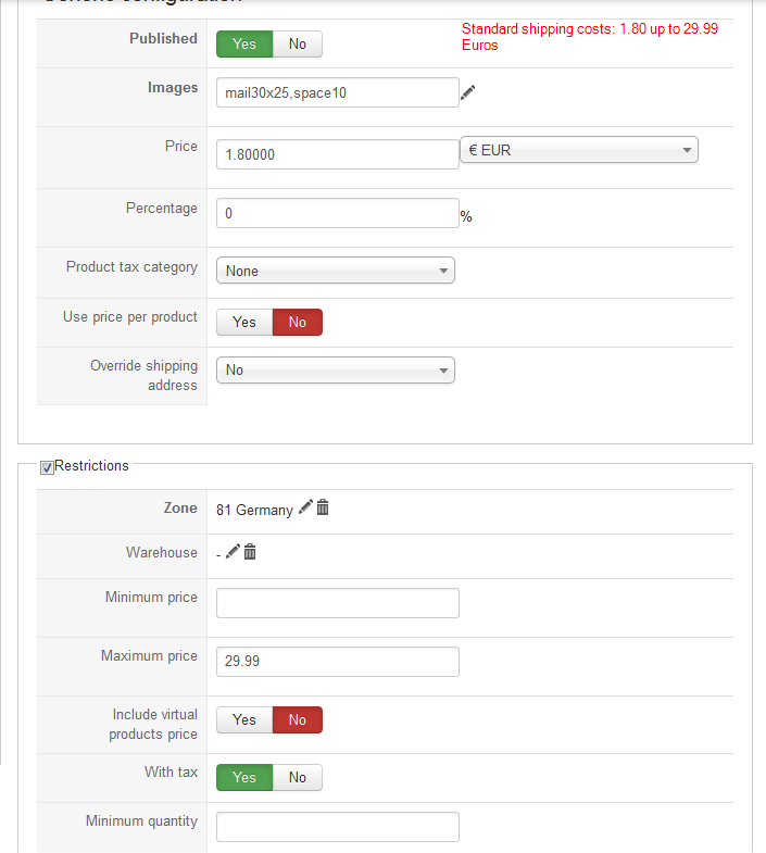

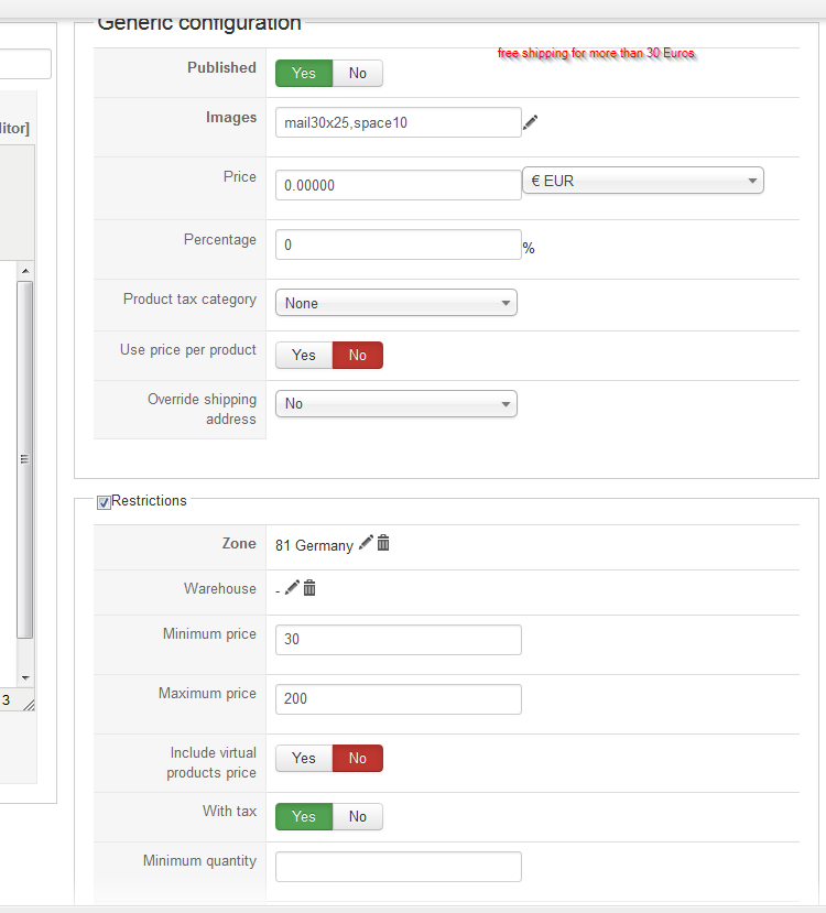

12 years 3 months ago #149070
here is a screenshot of my standard-shipping (up to 29.99 Euro) and the free-shipping for more than 30 Euros. The fields which don't fit on the screenshot are empty.

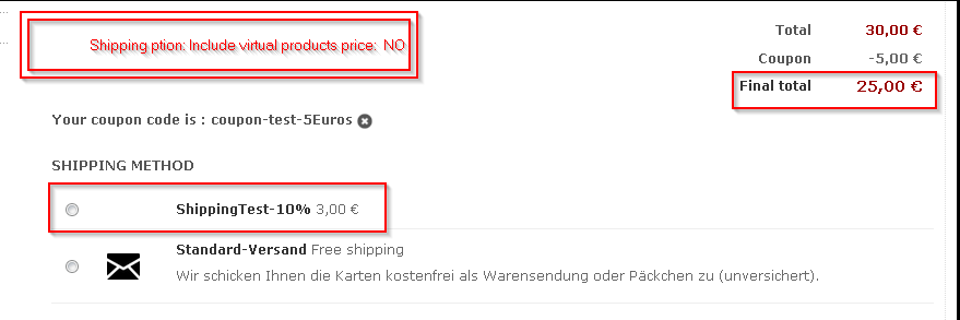

  • Posts: 11

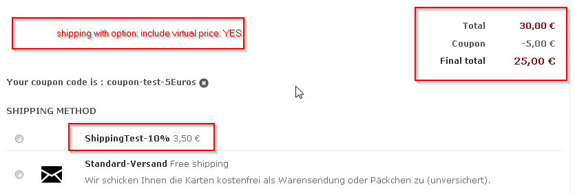

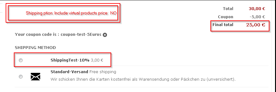

12 years 3 months ago #149315
Hi Mohamed,
for testing I have created a shipping method which will all 10%.
Then I ordered things for 30 Euros and added a coupon over 5 Euros. See the results in the screenshots:
Option: Include virtual products price" to NO:
Total: 30€
coupon:-5€
Final total: 25€
The 10%-test-shipping calculates: 30€ When a coupon is virtual product the calculation is undersandable.

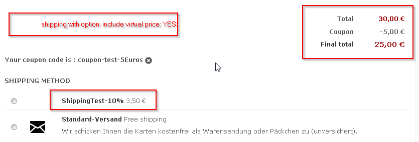

Option: Include virtual products price" to YES:
Total: 30€
coupon:-5€
Final total: 25€
The 10%-test-shipping calculates: 35€ This is abolutely strange behaviour. Because the shipping calculation adds the price of the coupon instead of subtracting.
Thank you for your effort!

12 years 2 months ago #149862
I just made a fix regarding that issue, so can you :
- edit the file : "\administrator\components\com_hikashop\classes\shipping.php"
- change these lines :
	if ($order->coupon->discount_flat_amount != 0)
		$order->shipping_prices[$key]->all_with_tax += $order->coupon->discount_flat_amount;
		$order->shipping_prices[$key]->all_without_tax += $order->coupon->discount_flat_amount;
By :
		$order->shipping_prices[$key]->all_with_tax -= $order->coupon->discount_flat_amount;
		$order->shipping_prices[$key]->all_without_tax -= $order->coupon->discount_flat_amount;
And test it again ?
Last edit: 12 years 2 months ago by Mohamed Thelji.
The following user(s) said Thank You: Marius
  • Posts: 11
12 years 2 months ago #150048
GREAT! it works!
Thank you very much!
