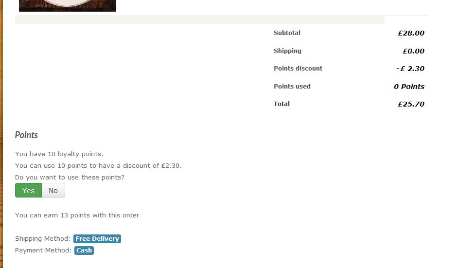

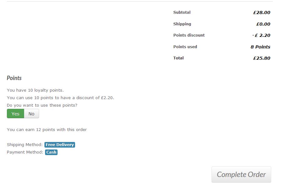

3. How do I configure the plugins so the customer can still earn points while spending them? Which option do I select please?
4. On the checkout at the points option, the points don't match. The messege says you can use 10 points but the balance says 8 points. Why please? Please see attachment.
5. On the checkout at the points option, when a user clicks NO and then back to YES, the number of points shows a 0. Is there a FIX for this bug please? Please see attachment.

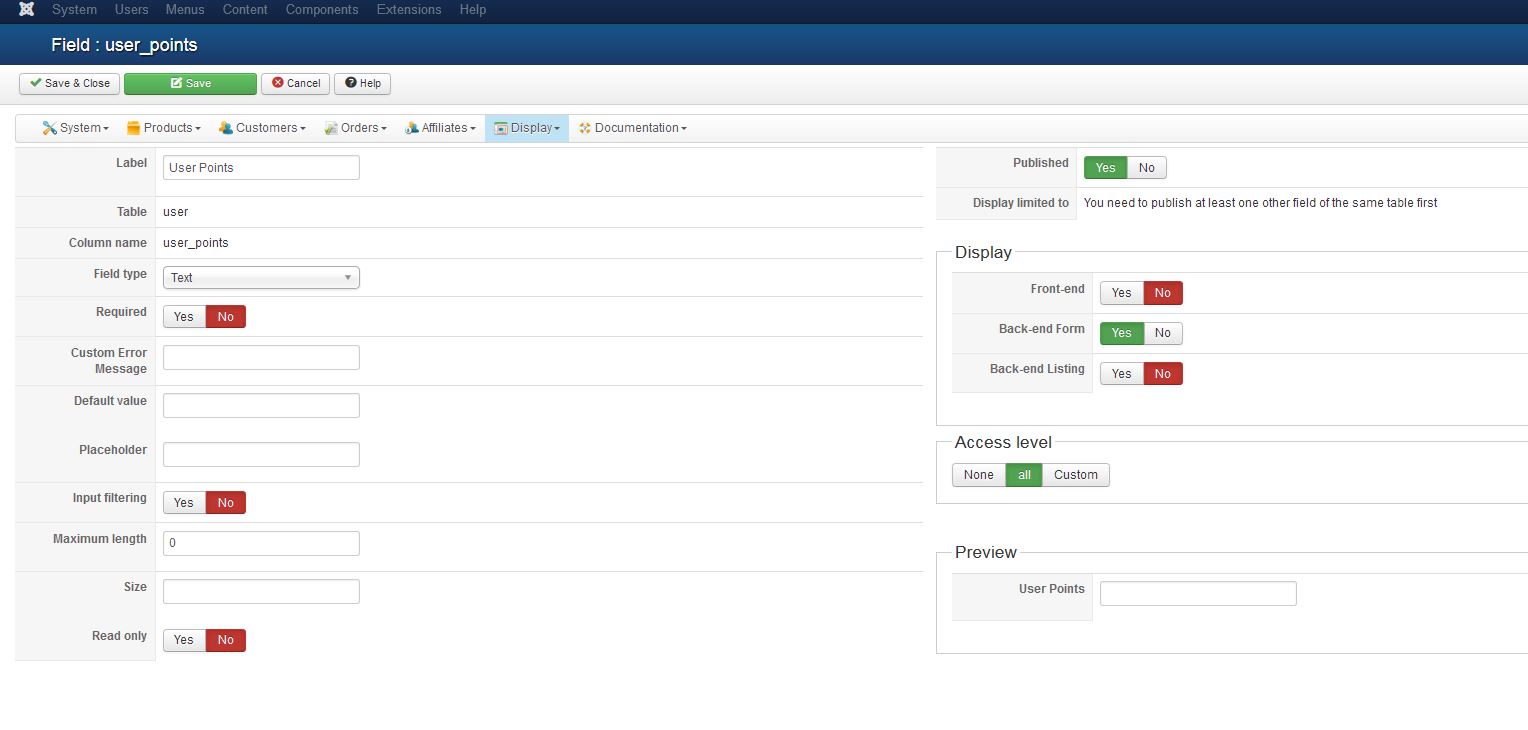

1. If you're using the user_points custom fields, you can display the value in a little module or to a specific view.
$user = hikashop_loadUser(true);
if($user) {
  echo JText::sprintf('USERPOINTS_HAVE_X_POINTS', (int)$user->user_points);

4 & 5. I think you have activated the virtual points ; which is a weird option that I dislike but some users asked for it.

4 & 5. I deactivated Virtual points and it does seem to work ok now. Virtual coupons seems to work Bug Free too. :)

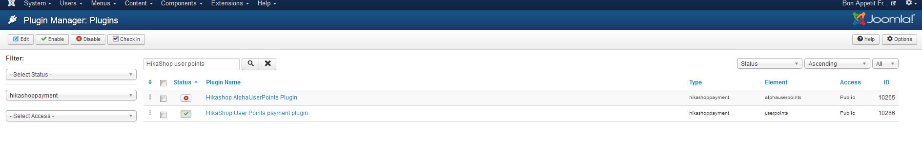

6. To earn points, you have to configure the "user points" plugin, in the "plugins" section and not in the "payment method" one.
The "user points" system is made of two plugins ; one to "use" the points (payment) and one to "gain" them (classical plugin).

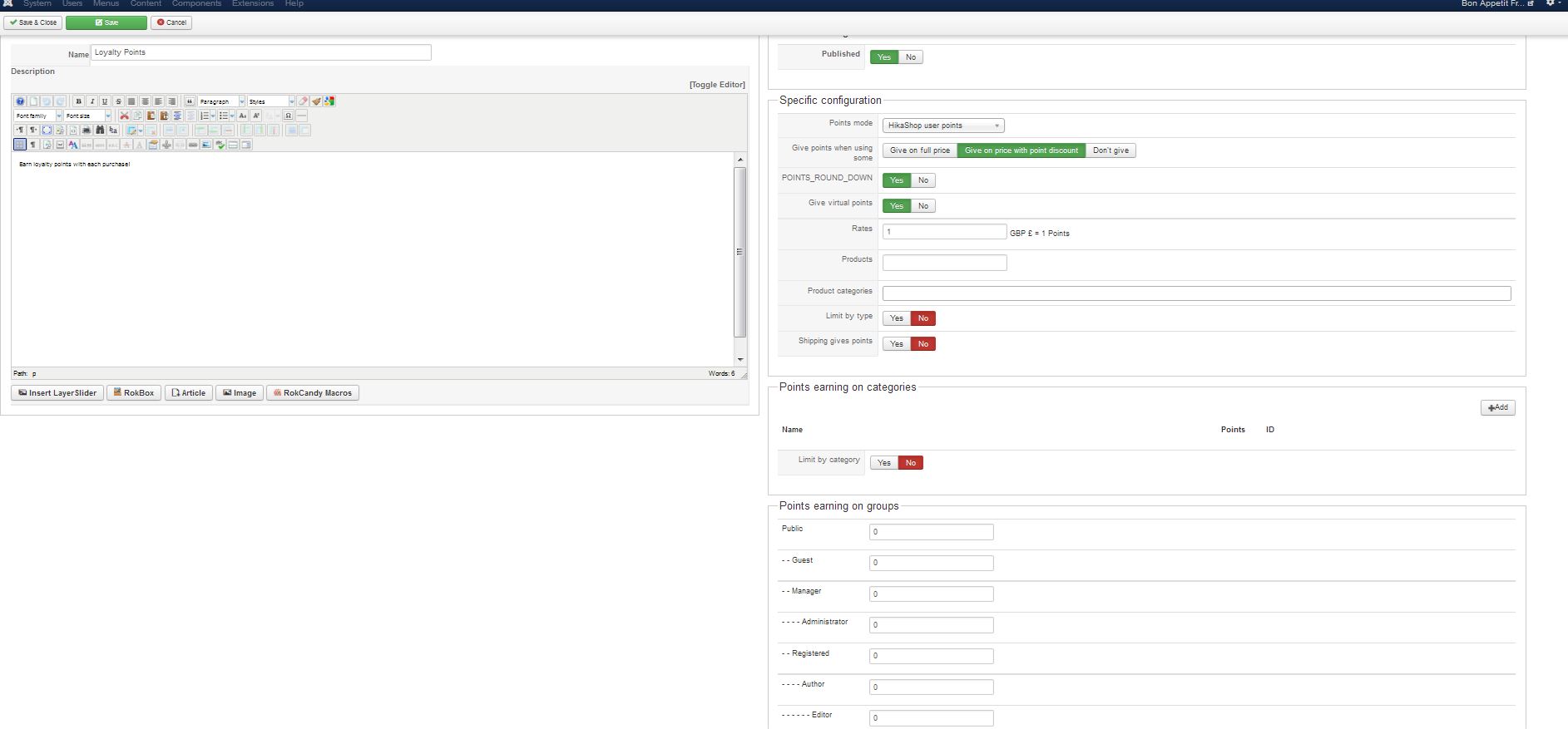

6. I know there are TWO PARTS to the plugin and I know the checkout page shows how many points a customer CAN EARN.
What I really need to know is:

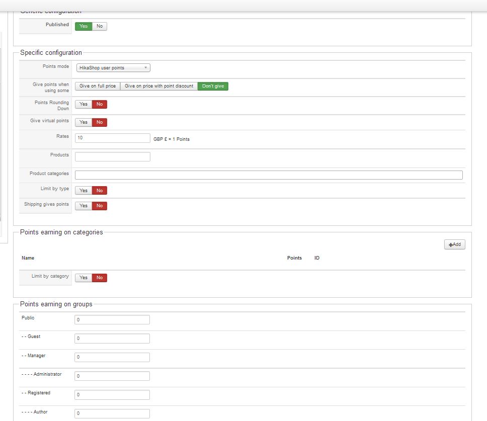

6.1: Why the points are not added to the customer's account once they have made a purchase, even though they are told how many points they can earn?
6.2: Can you look at my plugin settings and confirm they are set up correctly please? See attachment.

About your plugin configuration ; it looks good.
The plugin will give 1 points for every £10 spent and it won't give points if the customer is using some.
