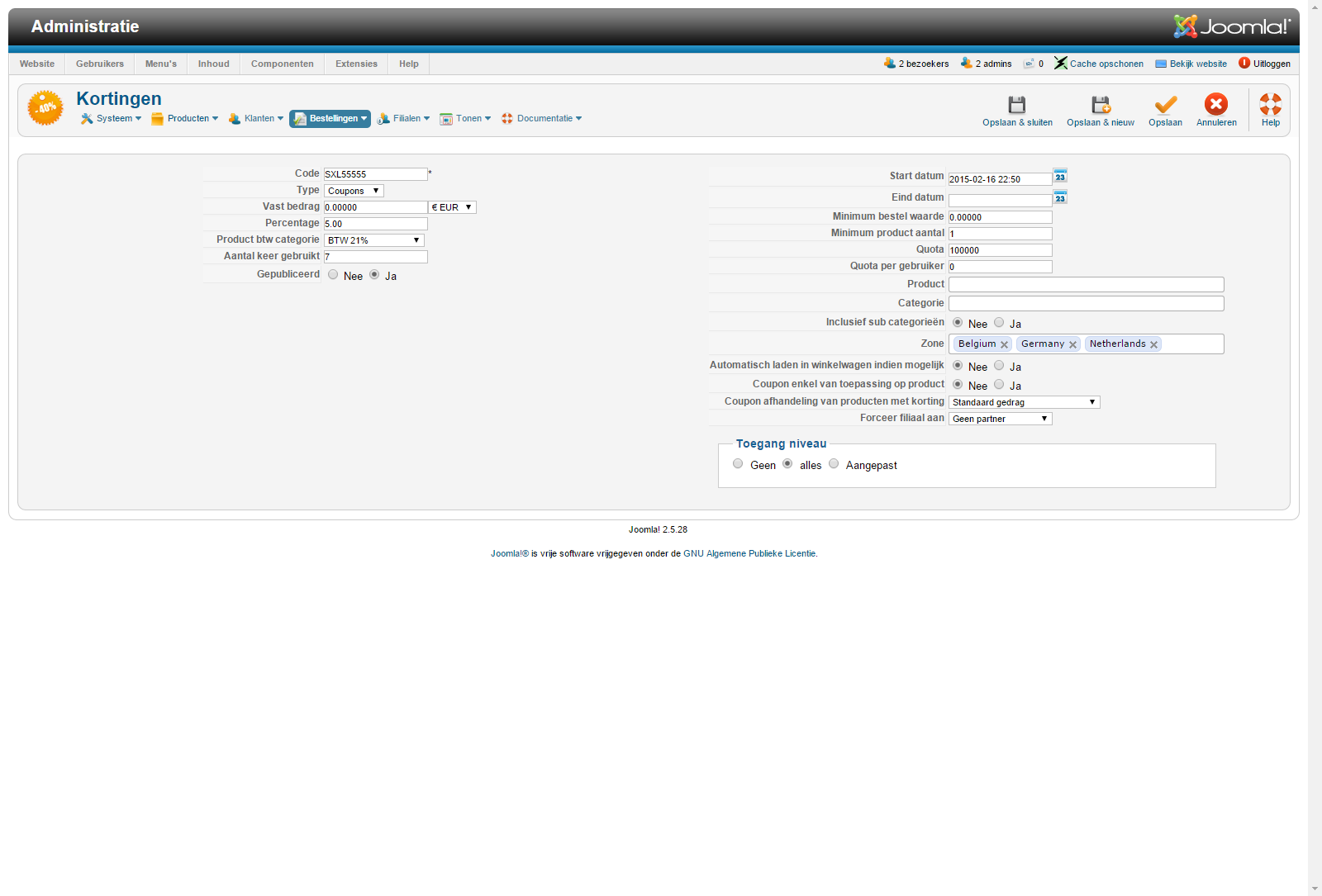

-- url of the page with the problem -- : www.schuurpapierxl.nl
-- Joomla version -- : 2.5.28
-- PHP version -- : 5.5
-- Error-message(debug-mod must be tuned on) -- : After adding a coupon code the shippingcosts are added
When an order is ready and more than € 100,- no shipping costs are required. But as soon as we add a coupon code like SXL55555, shippingcosts are added to the order.
Jan

11 years 2 weeks ago #204493
Please enable the option "Coupon percentage applies to product only" in the coupon settings.
Last edit: 11 years 2 weeks ago by Xavier.
The following user(s) said Thank You: janvankuijk
