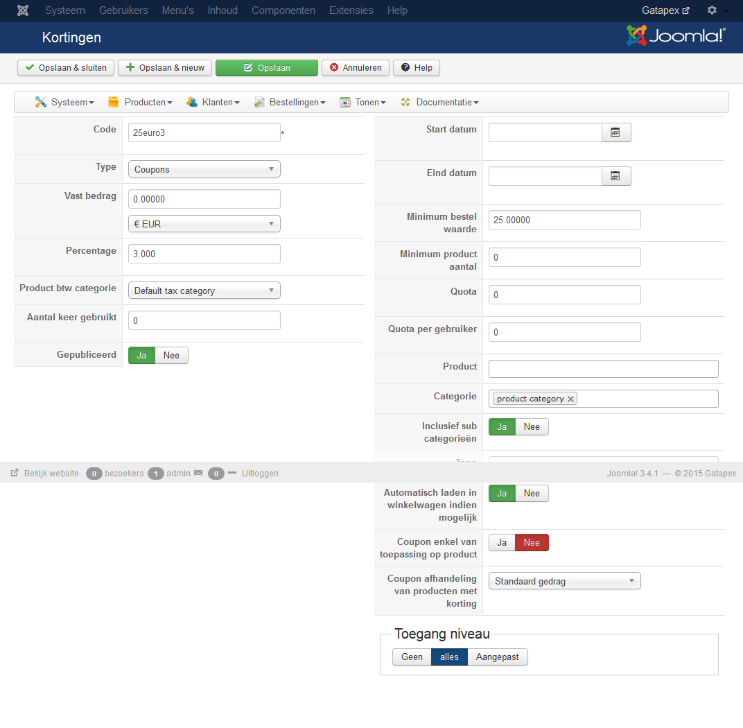

  • Posts: 62
10 years 10 months ago #210375
Of course! See attachment.
regards,
Joost
  • Posts: 26357
  • Thank you received: 4068
10 years 10 months ago #210436
Are you sure that you want an auto-loaded coupon ?
If you don't want a category restriction, the best is to not select a category. it is not impacting your current configuration but the coupon will use less resources for his processing.
After that, if I use the same configuration than yours ; I right have an auto-loaded coupon when my order cart is higher than 25€
But because it's an autoloaded coupon, I don't need to enter it, because HikaShop is loading it directly.
