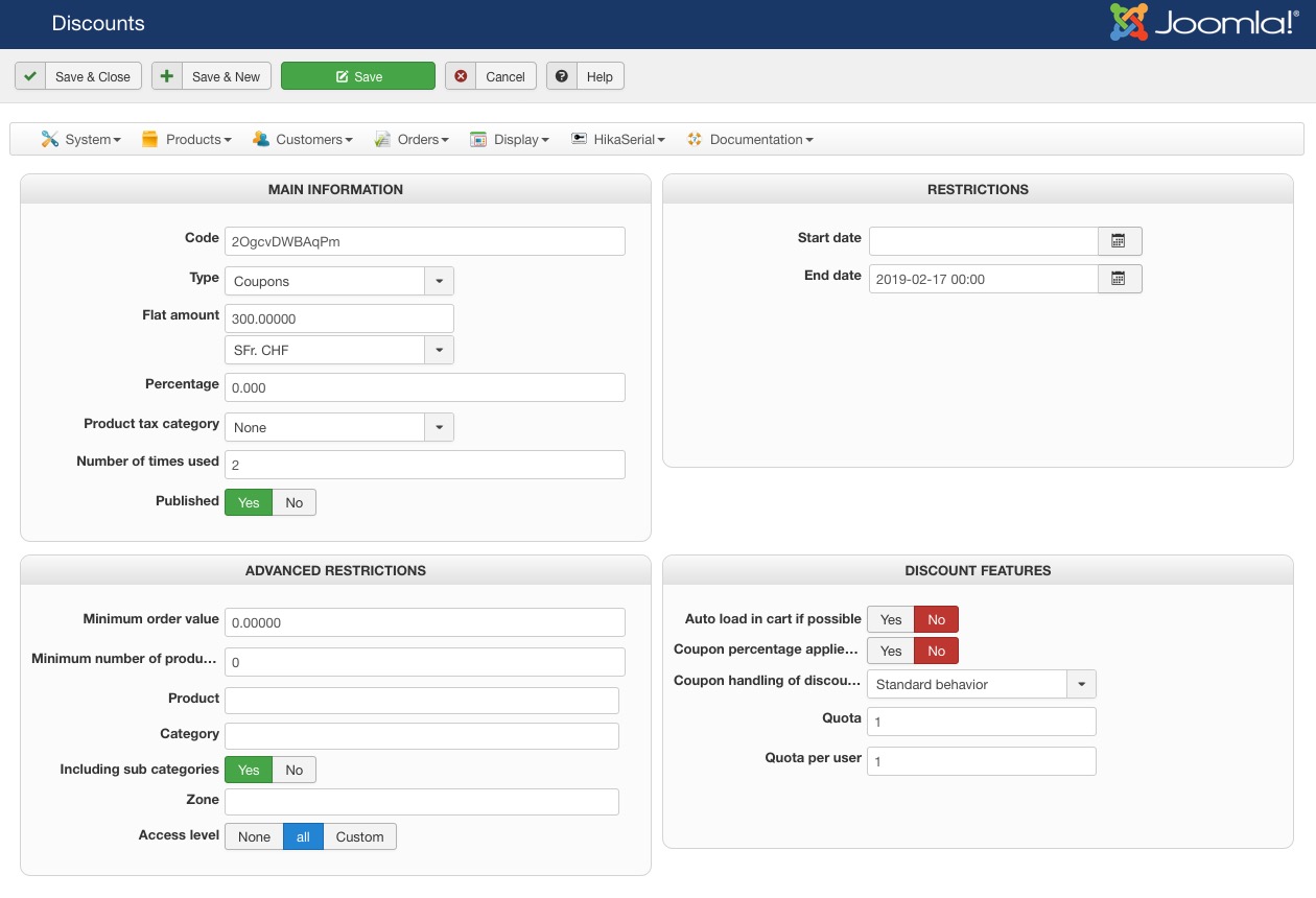

Good morning,
I use coupons for my site with quota one. companies buy for instance 40 coupons for their employees
It happens that a customer can't acheive the payment process for instance (mistake in credit card, digit mistake), it means that the order is created but not confirmed
It happens also that the customer phones me and ask to cancel his order and want to create another order.
Is there a way that a coupon given to the customer (usually with important value) can be used again for a new order, when an order is cancelled?
It means basically that it keeps its validity untill an order has a statut confirmed? (and is reactivated again if order cancelled)
On my coupon when I cancel or refund an order, the status of the coupon pass from 1 (1 left) to 1 (-1 left) and can't be re-used
Please find the configuration I have, should be something here!
Thank you for your help
Jean-Loup

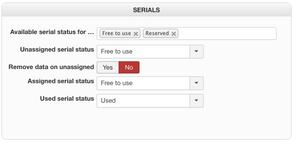

8 years 7 months ago #285874
I'm afraid that the HikaShop team won't be able to answer you correctly with your context explanation.
Please understand that there is no relation of any kind with HikaSerial so I recommend you to edit your message, remove all reference of HikaSerial and serials and then, reply to my message to let the HikaShop team do its job.
With your current message, since you're talking about HikaSerial (and you should not because there is no relation) they will assign that message to me thinking it's related to HikaSerial.. But it's not !
So if you want to provide a configuration screen ; you have to provide the HikaShop coupon settings.

OK Jérôme, sorry not always easy to realize this but now should be understood ;-)
So let's start again.
So I use coupons for my site with quota set on one. Companies buy for instance 40 coupons for their employees
It happens that a customer can't acheive the payment process (for instance mistake in credit card, digit mistake), it means that the order is created but not confirmed.
Is there a way that a coupon given to the customer (usually with important value) can be used again for a new order when an order is cancelled?
And even reactivated again if the order is cancelled after having been confirmed?
On my coupon when I cancel or refund an order, the status of the coupon pass from 1 (1 left) to 1 (-1 left) and can't be re-used. Please see coupon edition below
Jean-Loup

  • Posts: 86080
  • Thank you received: 14188
8 years 7 months ago #285983
Your settings look fine, looking at your screenshots.
Download the install package from our website and install again on your website. That will add all the latest patchs, including one regarding the coupons which should help.
