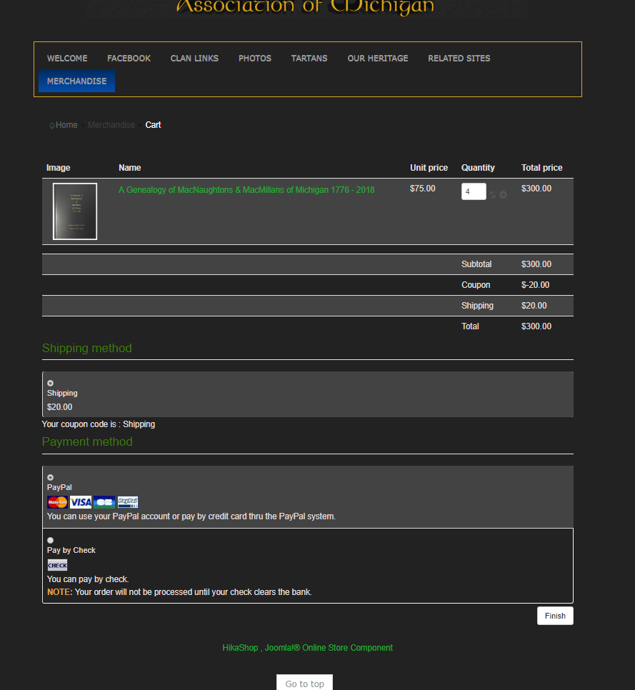

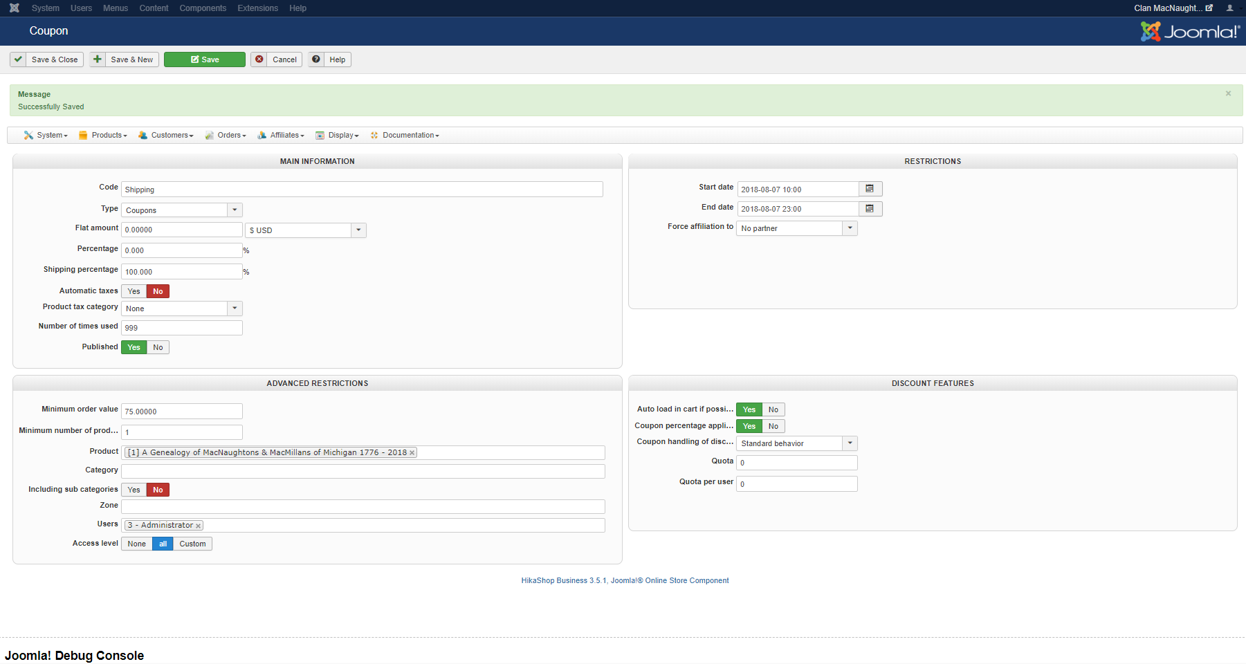

I have set up a one day discount for shipping on 1 item. (See capture Shipping Coupon.png)
But when I run a test, the discount is not applied to shipping but rather to the product. (See capture Check Out.png)
What am I doing wrong?
I realize the bottom line price is the same but for accounting purposes I would like to have the result appropriately shown.

I'm sorry but I don't understand your issue.
You have a coupon and its discount is the shipping price.
If you want a shipping with "0.00" price ; you will have to create a special shipping method.
But a coupon is a coupon ; a line in the cart which have a negative value.
And that coupon is applied on the shipping, with the value of the shipping..
So for what we can see ; it's working fine !
