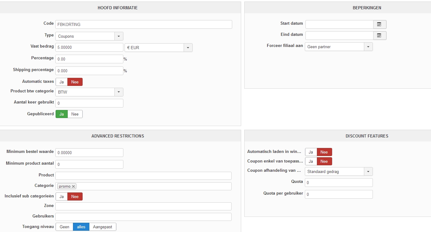

  • Posts: 10
5 years 9 months ago #323171
Hi Mohamed,
Screenshot attached. With that configuration I get 5 euro discount no matter how many products I buy.
I would like to see 10 euro discount if I buy two products.
With the font error I was referring to this 404 error GET /media/com_hikashop/webfonts/fa-solid-900.woff2 HTTP/1.0
regards,
John
  • Posts: 85727
  • Thank you received: 14056
5 years 9 months ago #323180
The coupon is for the whole cart. Once one product of the "promo" category is in the cart, the coupon can be used and it will get the 5€ you configured regardless of how much products are in the cart.
You can use the "percentage" setting if you want the value of the coupon to be based on the products in the cart.
And you can activate the "coupon percentage only for products in category" setting if you want to restrict that to only the products of the category you selected to be taken into account.
