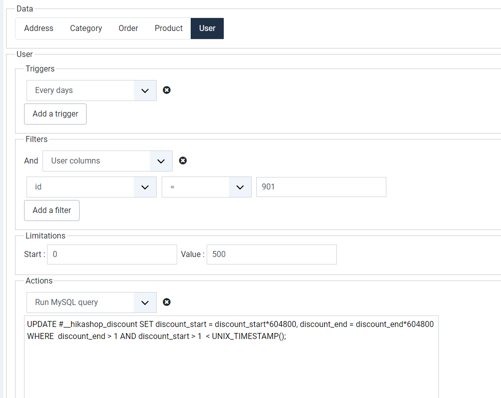

I have made a discount for 10% then in mass action with these settings as you gave me.. But the date of discount will go from 2023-11-07 11.24 to 2106-02-07 07:28
What am i doing wrong? the time zone in Global configuration is on Amsterdam.
hope you can help me a little further..
Thanks in advance

2 years 9 months ago #356542
forgot to sent allong my settings :)

2 years 9 months ago #356543
My bad, I was a bit fast when writing the MySQL query :)
I wrote * instead of +. Of course the seconds of 1 week ( 604800 ) need to be added to the existing date, and not multiplying it.
So the query should be:
UPDATE #__hikashop_discount SET discount_start = discount_start+604800, discount_end = discount_end+604800 WHERE discount_end > 1 AND discount_start > 1 AND discount_end < UNIX_TIMESTAMP();

2 years 9 months ago #356554
No problem.. I tested it with this and after processing mass action, the discount neatly went 7 days ahead.. yes to next week tuesday.
Does the mass action goes automaticly now? or do i have to make a cron job for this?
thanks..

2 years 9 months ago #356555
You need to cron job to be set up so that the query can run every day. And the query will only update the discount if the end date is in the past, so it's not a problem if it runs every day.
