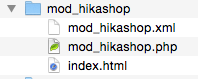

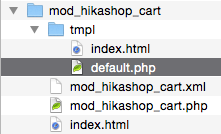

  • Posts: 2687
  • Thank you received: 71
10 years 10 months ago #212381
a tmpl folder for each mod_
in my template
if(!empty($html)){echo $html;  }
same here (tmpl missing)
Last edit: 10 years 10 months ago by erickb.
