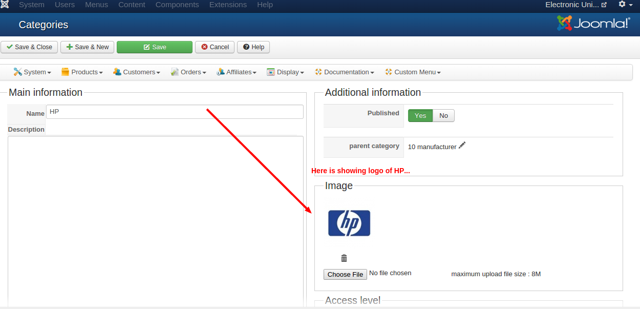

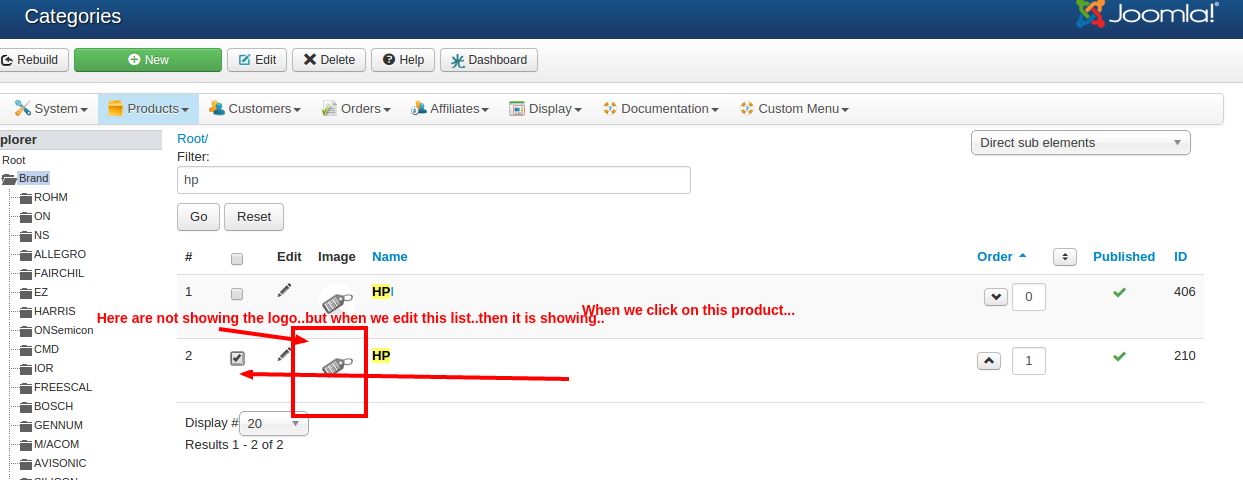

Hi Sir,
Manufacturer images are not showing.I checked images are exists in "hikashop_file" table in database.What is the issues.I did not find it.Please help as soon as possible.
I have already attached the screen-shot.Before it is showing as per screen-shot..

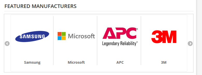

Hi Sir,
I have checked and noticed that images are exists in this folder "/com_hikashop/upload/".and also please check my attachment. It is not showing on front-end in manufacturer list.

You have the same issue with some products.
I think that your website do not have the right to create thumbnails anymore ; it should be something related to the write access for the folder "/media/com_hikashop/upload/thumbnails/" or just the "/media/com_hikashop/upload/thumbnails/50x50fsO" one.
But if you have the issue also in the front-end ; more folder thumbnails could be involved.
