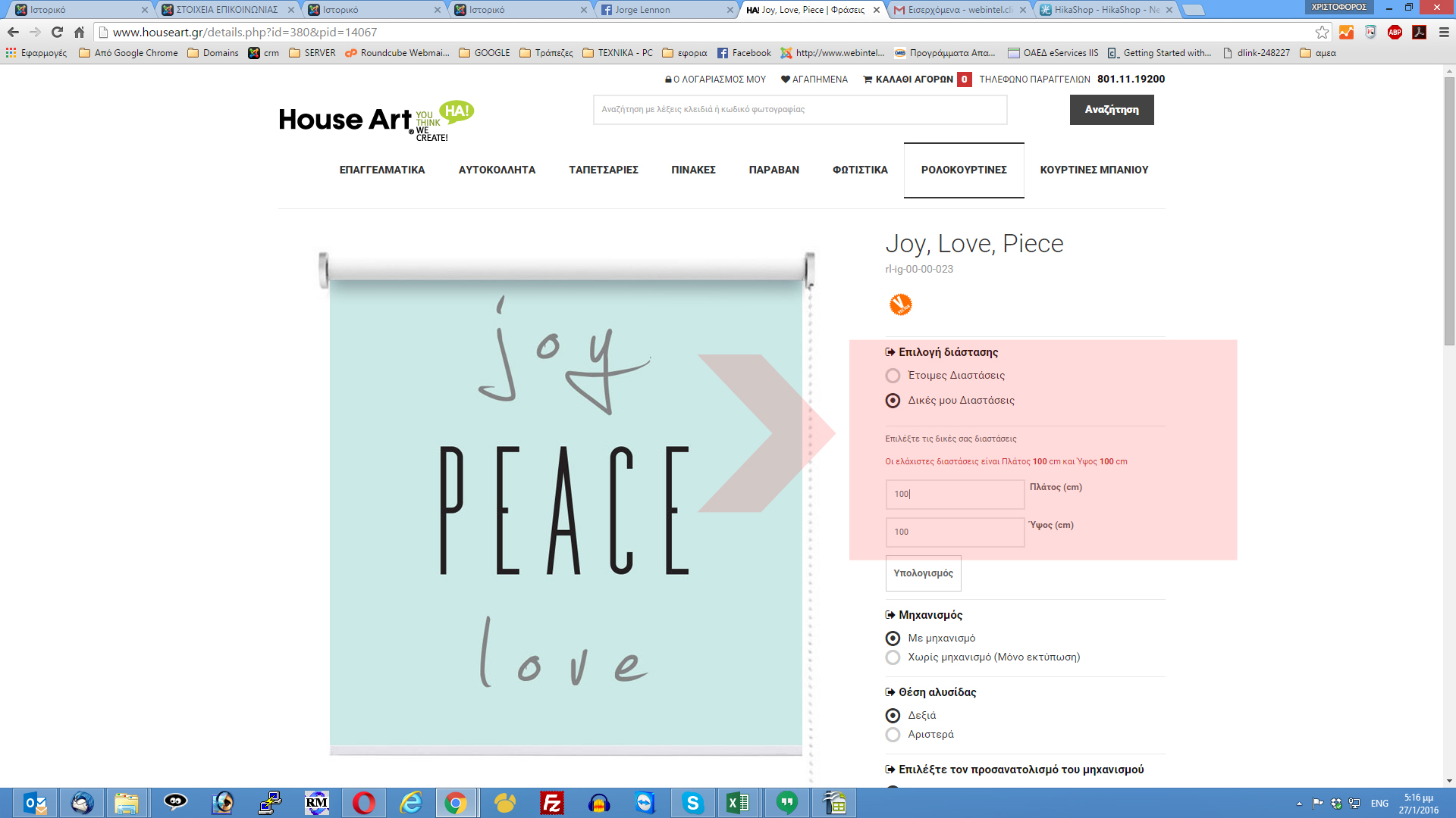

Is it possible to create a plugin that will do the following.
I need to write down in 2 fields numbers that will calculate the price of the product, and then add it in the basket with the price calcuted.
So I need
1.(i suppose I need) a text area to write down the code to calculate (ex. width and height of product) , id of this entry, field to assign it on specifiq categories or products,
A + button to use more like these for differnt products.
Please give me a price
an example is here
http://www. houseart . gr/ details.php? id=380&pid=14067
look at the
Δικές μου Διαστάσεις
