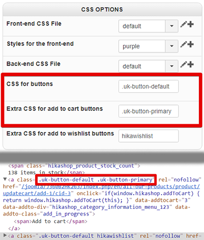

I have a request for the CSS Buttons options in the configuration.
As you know you can add an extra CSS class for cart and wishlist. That's very nice.
But this option is not workable anymore for Yootheme PRO and for example JSN, and maybe other templatebuilder.
For example if somebody want to use a secondary button for the shop you have to add these classes:
"uk-button uk-button-secondary" for Yootheme PRO.
And if you want an other class for the add to cart buttons you have to add this class.
Like this situation:

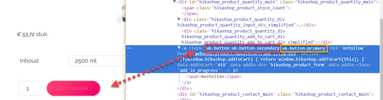

But this situation give a problem as you see. Because when you use the extra CSS class, the extra CSS will be placed behind the CSS for normal shop buttons like this:
"uk-button uk-button-secondary uk-button-primary"
but it must be look like this:
"uk-button uk-button-primary"

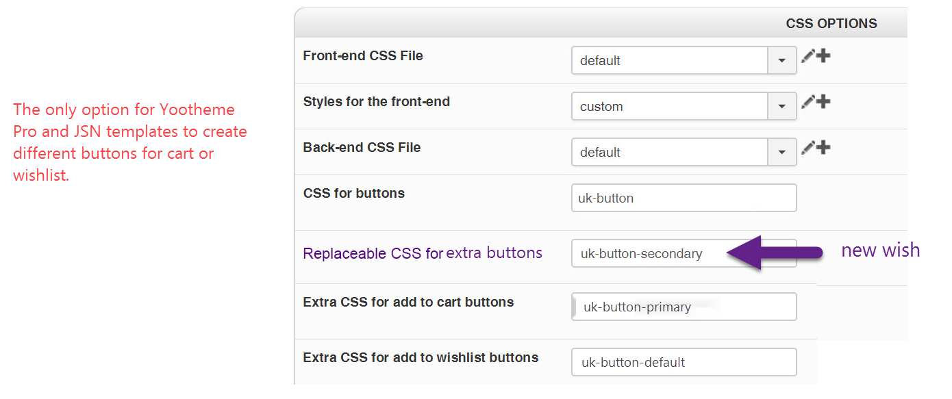

Create a extra field with a replaceable CSS button class. So this class would be replaced by the extra classes for cart and wishlist.
Like this example:
I hope you understand the problem and correct me if I'm wrong. ;)

There is something I don't understand in your first screenshot, from where come from your "Replaceable Css for buttons" ?
I don't have this input...

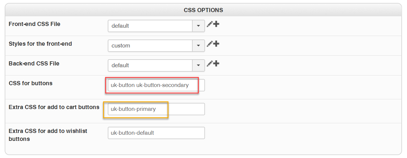

Anyway, here my configuration that leads to, I think the results you want to have :
Awaiting news from you.

Hi Philip, I made an update from my post. So hopefully you understand it now better.
Please also see the new structure from Yootheme Pro for the buttons on:

Ok, I get it but I think the way I configure must fit your needs... Did it ?
In your first post, you have talking about a specific case, normally my answer (at least if I make no mistake...) must answer to this concrete case.
