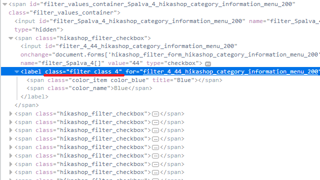

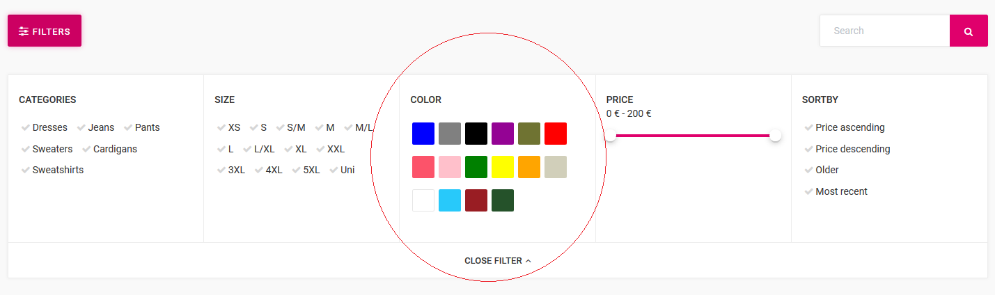

Could hikashop consider to add classes for labels inside filters?
We have modified administrator/components/com_hikashop/classes/filter.php file for our needs but we hope this could be added by default. It's small improvement/code...
I have attached screenshots.
It would allow to have different background color for color filtering using css and wont need any img src as per your documentation here: www.hikashop.com/support/support/documen...by-color.html#filter
Cause now to have this you need to add some span class via characteristics values and this makes some issues for product import/export. Then you have to use css to hide it in cart view during checkout and so on...
I hope you see my point.

That's a good idea. We'll add classes to them.

Great. Please don't forget that classes should be dynamic so we could have different css styling for it.

Just after update to 3.4.0 i found that you only added label classes for radio buttons but not for checkboxes? :(
Is there a reason why? The checkbox allows to select more then one filtering...

I believe I've added the classes for both since the checkbox filters inherit from the radio filters.
If I've missed something I'll be happy to add it if you can provide more details.

That's strange after i switched to radio and back to checkbox the classes on labels started to show. Maybe some cache...
All working fine now.
