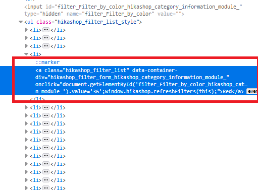

2. Using Filter type list. Now if one of this filter values are selected there is no indication for that value that it is selected. Would be great to have some class here like "filter_selected" or something. So we could make some css styling for it. Small change but very useful!
Also it would be great if you could select more filters not only one...while using filter type list.
