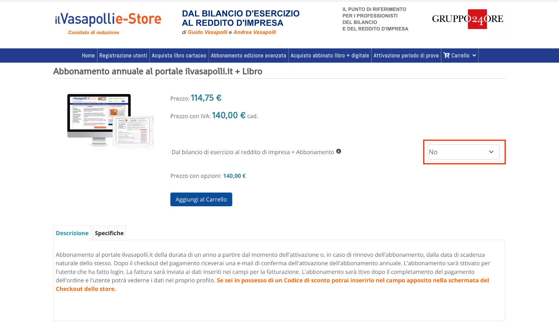

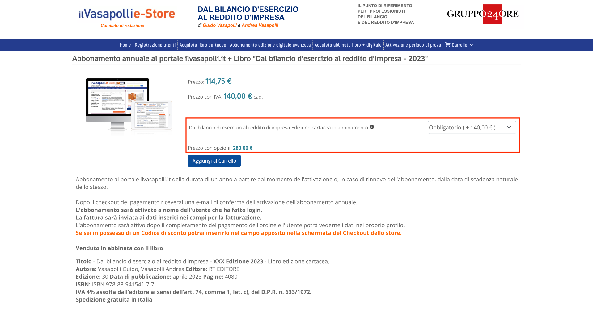

we managed to create the product in a "bundle", combining the two products that I had indicated previously. They now appear separately in the cart. But there are two important problems that I think you can help us solve.
1. On the product page (Screenshot1) the combined product appears as a possible option and not as a "mandatory" combined product. We read your response to the "bundled products how to" ticket where you said: "If product Y is added as an option to product X, the customer will be able to purchase product
And if you have Product Y in an unpublished category, Product Y (DEAL) is only available if a customer purchases Product X. Product Y is not available as a standalone product and can only be added to the cart with Product X.
We did this, but product Y, in our case sku abblib appears as an option not as a mandatory purchase.

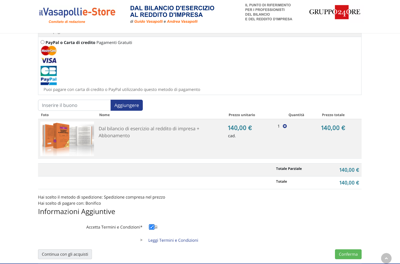

2. By proceeding with the purchase by going to the checkout (Screenshot2), the option to delete one of the two products remains active.
In this way, if I delete it and proceed with the purchase, I successfully purchase only one of the products which has a discounted price to be sold together (Screenshot3) and this, obviously, is not good.

In order to get what you required, we can sugget you a "trick", you can use a variant in order to remove the "No".
Removing the No can be done for the option itself (not for all the options) by adding a characteristic with only one value to the option product and having only one variant, follow me step by step :
1. Create a Characteristics, let's say "Product options" (by example) with variant "Mandatory" & "No"
2. In your product options create, add your characteristic "Product options", SAVE
3. In your new variants Tab, Add only ONE Variants with "Mandatory"
Result :
Your product options selection will be now without any No choice, even if the product option itself is alone (It will be required).
Hope this will help you to achieve your needs.

2 years 10 months ago #356492
The first part of the problem has been solved. Thank you. (Screenshot1).

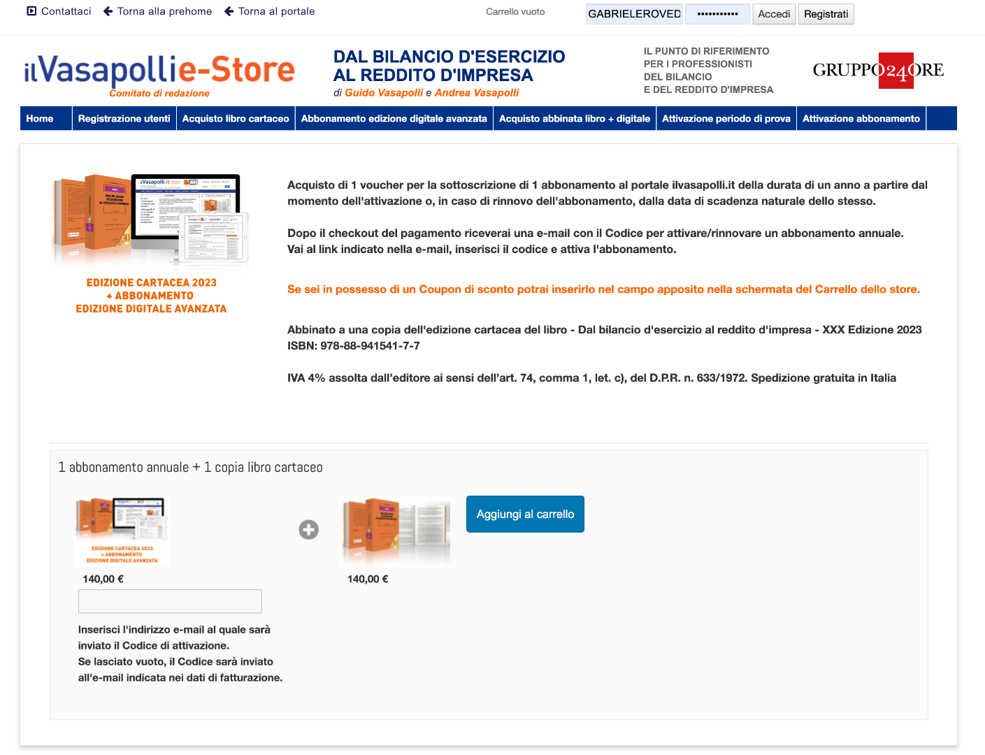

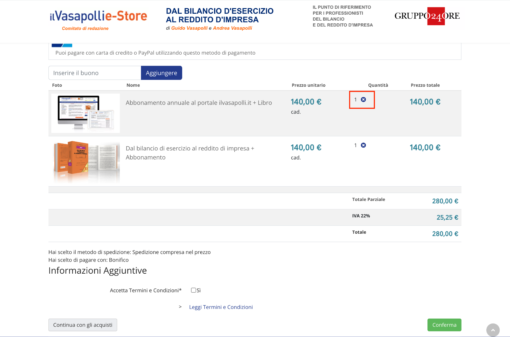

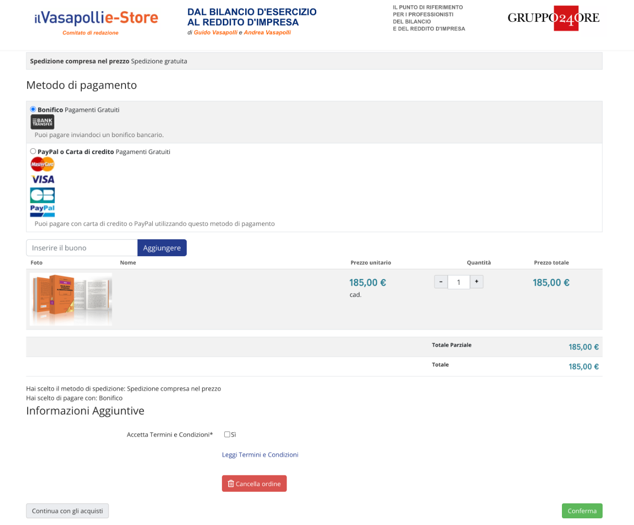

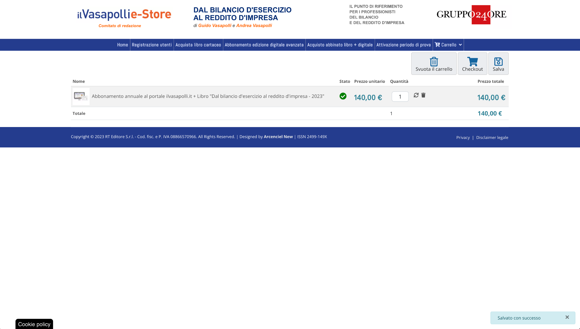

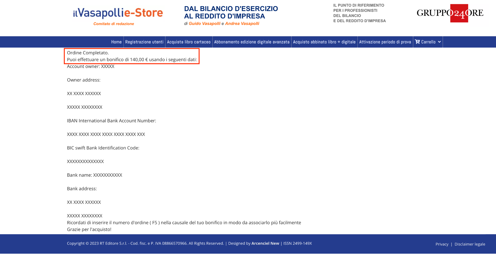

When you add the 2 combined products to the cart it is still possible to cancel one of the two. (Screenshots 2 and 3)

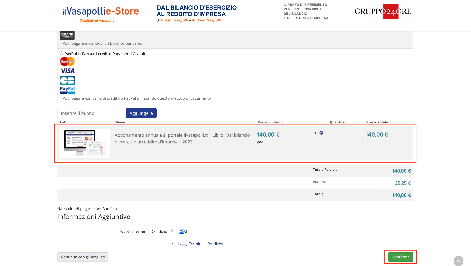

So if you go to checkout you will only find one of the 2 products with the discounted price (Screenshot 4) and you can complete the order (Screenshot 5) by purchasing only one of the two products with the discounted price. You understand that this is a problem. So what can be done to continue the matching obligation also in the purchasing process?

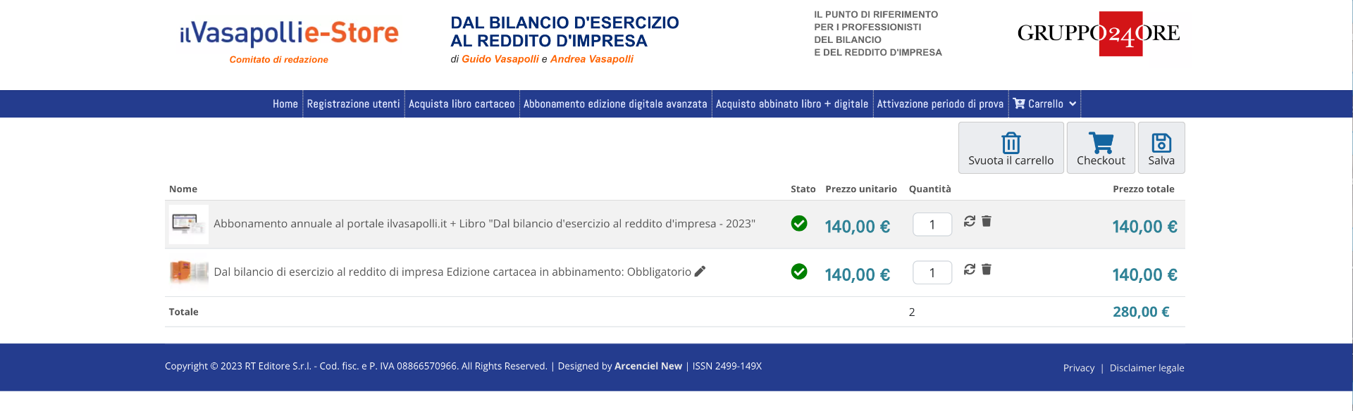

2 years 10 months ago #356495
Maybe I think I have a solution. In Virtuemart we had the same problem where we hid the buttons to cancel products both in the cart and in the checkout. And we have added a "Cancel Order" button in Checkout. Now I'll talk to my developers and let you know. But please make it a bundle module. :))
  • Posts: 46
  • Thank you received: 8
  • Hikaserial Subscription Hikashop Business
2 years 10 months ago #356501
So, we solved it. The only thing missing is the correct script to cancel the order on the checkout page. You should tell us. We have inserted a button as a custom field (Screenshot1)
<button style="margin-top:20px;" type="submit" class="hikabtn hikabtn-danger hikabtn_checkout_next" onclick="return window.checkout.confirmDelete(this);"><span class="btnIcon hk-icon fa-2x" style="font-size:16px !important"><i class="far fa-trash-alt"></i></span> Cancel order</button>
but obviously it doesn't work. You should indicate the command to insert in onclick.
