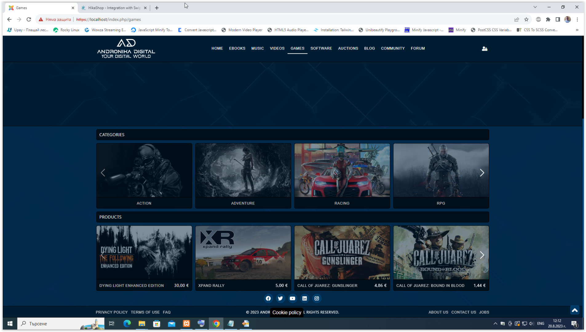

2 years 11 months ago #354510
Hi, I'm almost done with Swiper integration and will post the code tomorrow based on /components/com_hikashop/views/category/tmpl/carousel.php. I rewrote some of the code so that everything works correctly. If you choose you can use it as a base, I have ported most of the functions from owl carousel.

2 years 11 months ago #354526
100% working code with all features. A big battle was with the additional Pagination types :)

$thumbnailWidth=$this->params->get('pagination_image_width');
if(empty($thumbnailWidth)&&empty($thumbnailHeight)){
$thumbnailHeight=$this->image->main_thumbnail_y/4;
$thumbnailWidth=$this->image->main_thumbnail_x/4;
$img=$this->image->getThumbnail(@$this->row->file_path,array('width'=>$thumbnailWidth,'height'=>$thumbnailHeight),array('default'=>true,'forcesize'=>$this->config->get('image_force_size',true),'scale'=>$this->config->get('image_scale_mode','inside')));
if($img->success)$thumbs_data='<img src="'.$img->url.'" />';
break;
$pagination_html.='<div class="swiper-slide">'.$thumbs_data.'</div>';
$pagination_html.='</div></div>';
echo $pagination_html;

  • Posts: 85952
  • Thank you received: 14140
2 years 11 months ago #354532
Thanks a lot ! I've integrated it on my end. It works great as far as I can see.
Thanks very much. We'll be able to add this to the next version of HikaShop.

As you can see, I've removed the javascript file you have since I don't use your template. I've taken the swiper bundle JS AND CSS files from the official website and added them to HikaShop. They will be autoloaded with the hikashop_loadJsLib call at the beginning, like owl was loaded in the past.
Regarding extra effects, it's possible but I must say I'm not familiar enough with the swiper API at the moment.
The file administrator/components/com_hikashop/types/effect.php contains the list of available effects for the carousel.
So adding extra choices there is quite easy.
I suppose the best will be to add a check on
$config = hikashop_config(); $config->get('carousel_version', 'swiper');
so that we would only add extra effects to the selector when swiper would be used.
