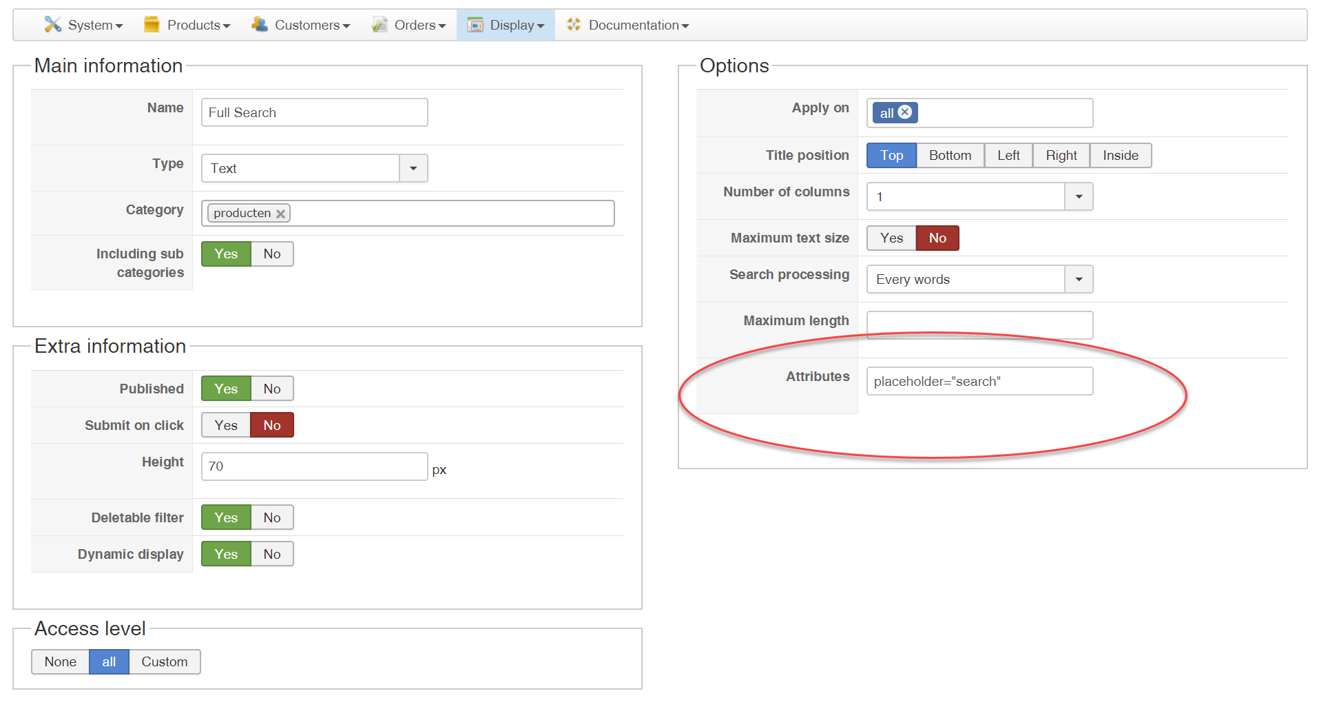

8 years 6 months ago #284764
Hi Jerome,
Is there a more simple way 4 years later? Can I add something to the filter view?
Or can you please make a small improvement to the filter under Display>Filters (type text) to add an extra placeholder field?
So we could use that, because I think a lot of people would like to have a placeholder for the type text.
Hope to hear from you.
Kind regards,
Lumiga
Kind regards,
Lumiga
  • Posts: 85860
  • Thank you received: 14101
8 years 6 months ago #284767
There is no option for that for now so you would have to edit the filter view.
However, that's a good idea. We'll look at adding an option for that in the next version of HikaShop which is to be released soon.
  • Posts: 632
  • Thank you received: 25
8 years 6 months ago #284780
Oké perfect in that case I'll wait for the new release. ;-)
Kind regards,
Lumiga
  • Posts: 632
8 years 6 months ago #284931
Thanks Nicolas and the rest of the team!
This works great for me. ;-)
Kind regards,
Lumiga
