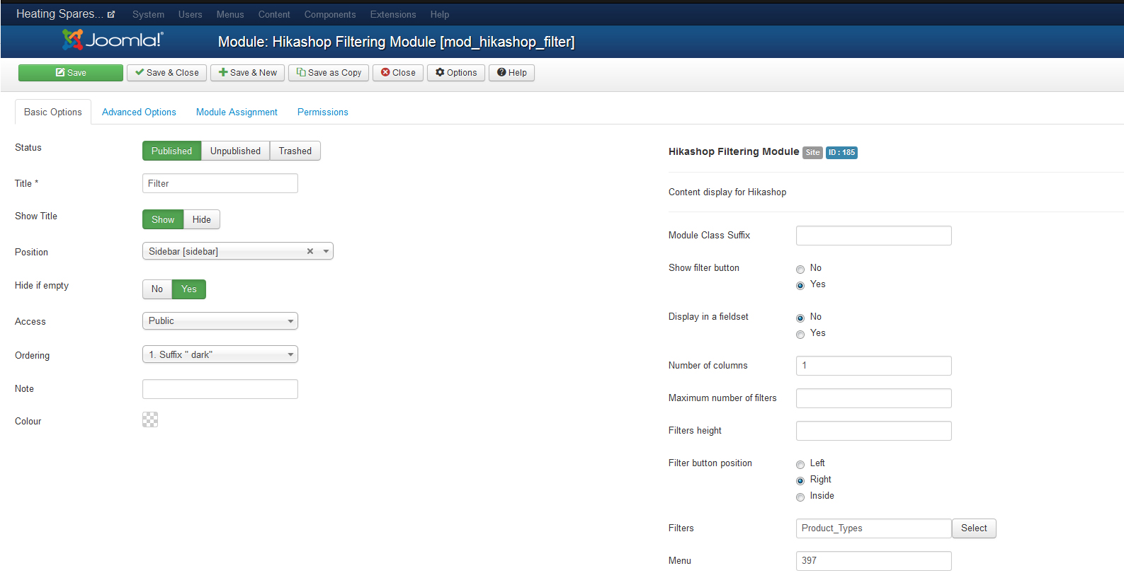

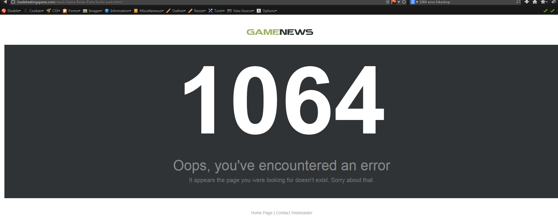

Hi, for some reason when i have my filter module published, on those pages i get a 404 error (attached). What i have done is create a new field type for product with checkbox as the select type and have added two values. I then created a module and selected my filter i wanted to display and published this on the front end however if i now navigate to any page it is supposed to be published on i get a 1064 error when trying to load it. I have tried adjusting a few bits to see if i can get it to show at all and it doesn't seem to want to show it.

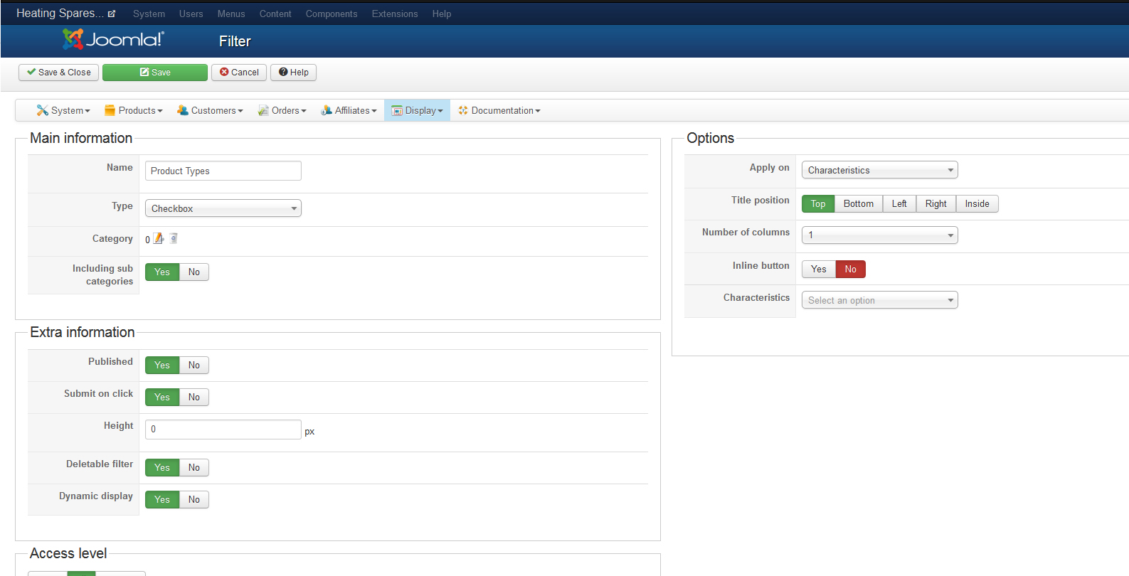

What i am trying to do is set a custom field so that when someone clicks to a product listing they can show only the 'burners' or show only the 'heat exchangers' to save the person time from looking through all the pages.

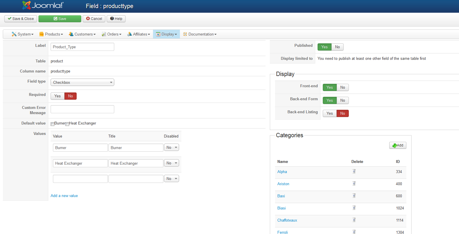

So what i have done so far is create a custom field - and added it to the product table (i guess this is the best place?) I have then also added a couple of test values to this custom field so that i can go add then to my product pages.
In the filter however i see no link between the drop down 'apply on' that relate to my custom field that i setup above.
But then in my module (attached) i have also added the 'product_types' filter to this...
My problem seems to be in linking the custom field to the filter...
Alex

If you want to do a filter on a custom field, then you should select "custom field" in the "apply on" option of the filter.
I tried on my end with the 2.2.2 and I can select it. If you select characteristic instead, then you won't be able to have your filter on your custom field.

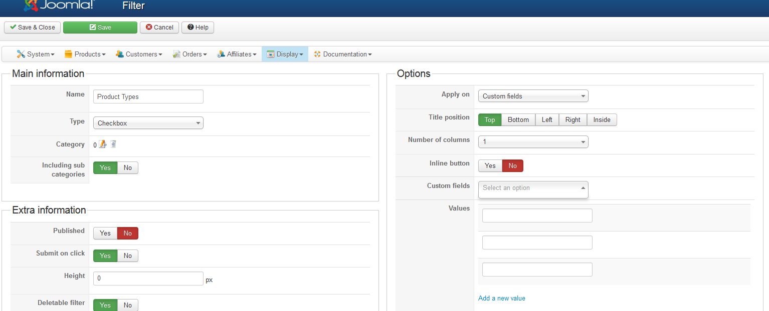

Hi I see the custom field drop down, but this doesn't allow me to select my custom field, instead it is asking me to add new options. So if i put a few values in then great it shows on the front end but these values don't have any relationship to the products so i don't really understand again how i link the filer to the custom field and therefore filter the products based on this custom field? Do i need to re-enter the same values that match the values in the custom field? Sorry i did look at the documentation but it doesn't seem to go into that much detail on filtering.

You should keep the values empty and select the custom field in the "custom field" option that you can see in your screenshot.

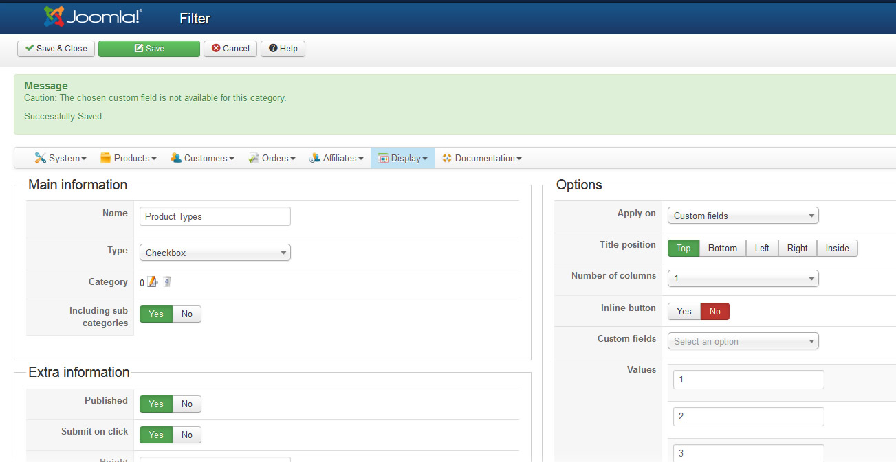

Thats what i was expecting to be able to do but the drop down is empty. I cannot see my custom field in there. Please see attached. Did i add my custom field to the wrong table or something?
12 years 10 months ago #127807
You should save your filter at least one time, then your filter will be able to load all the custom fields through the "custom fields" option.
