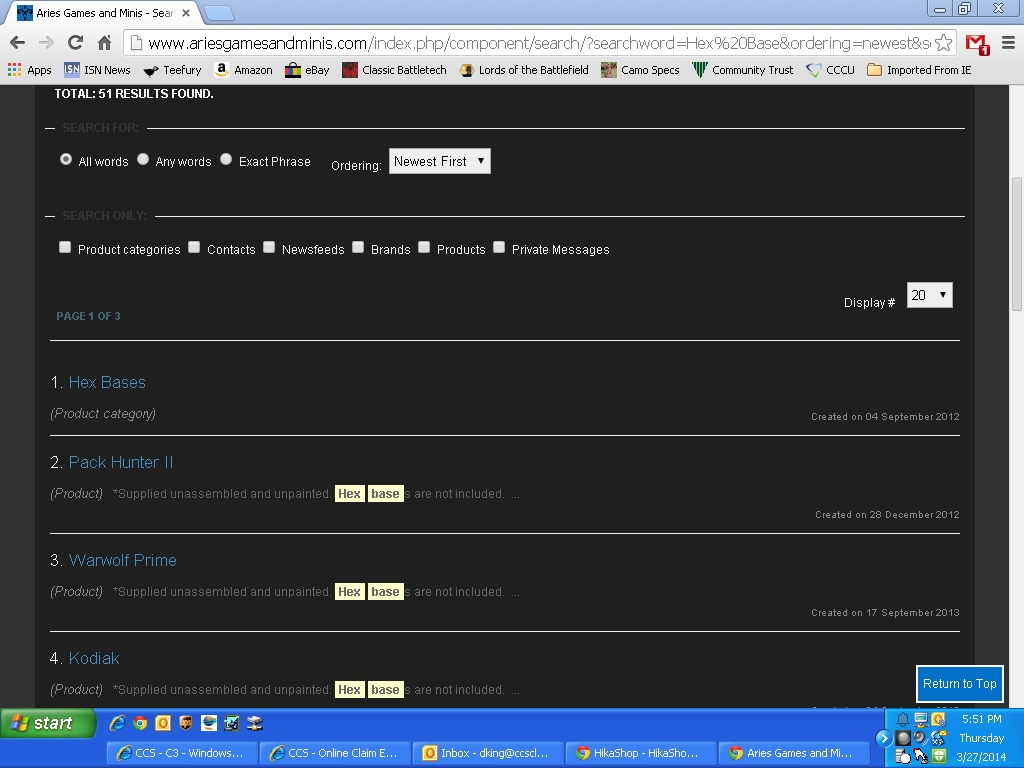

All,

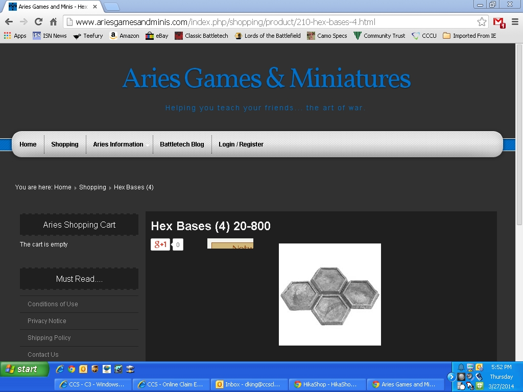

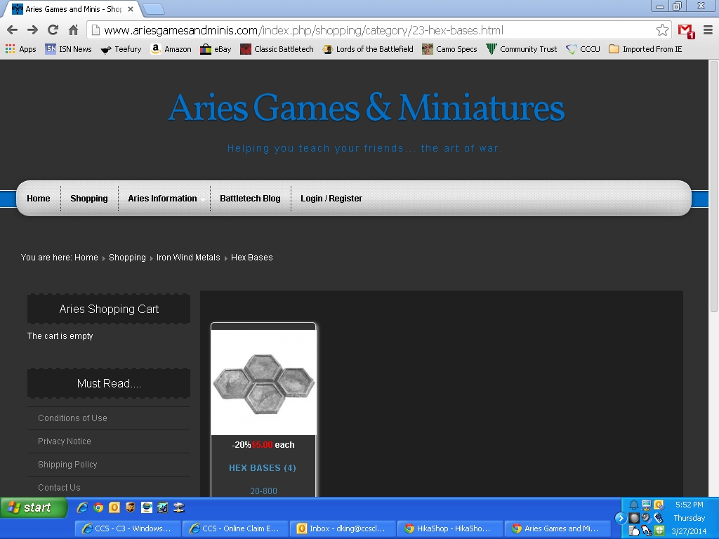

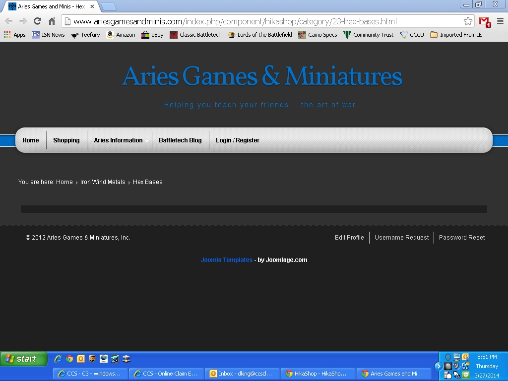

The search feature works on my site, but I've run in to 1 issue. When I search out either "Hex" or "Hex Base" I get the product category...not the product. Please see the attached images. Image #1 is what I get when I search "Hex" or "Hex Base"...the link is the first one that comes up, Image #2 is of the page that link takes me to, Image #3 & #4 is of the page where the Hex Bases actually are.
How do I fix this? This caused a customer NOT to buy the items they wanted.

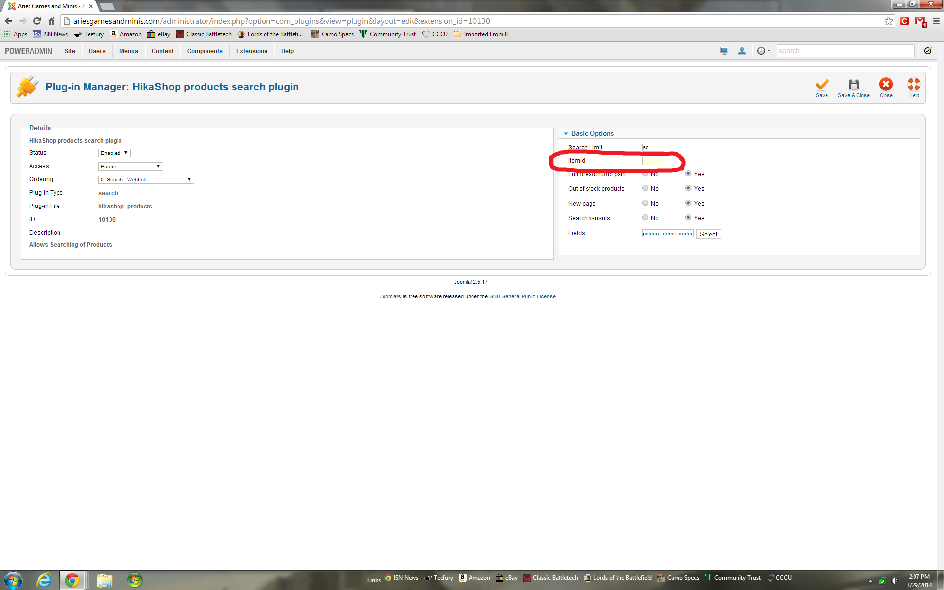

Thanks to check the parameters for the plugin "HikaShop products search plugin", in the basic options check if you have things like "product_name","product_code" for "Fields".
And check if that plugin is enabled.

That's because in the itemid option of your HikaShop products search plugin, you need to enter the id of a products listing menu item.

As I said, you need to enter the id of a products listing menu item in the "Itemid" option of your HikaShop products search plugin via the joomla plugins manager.

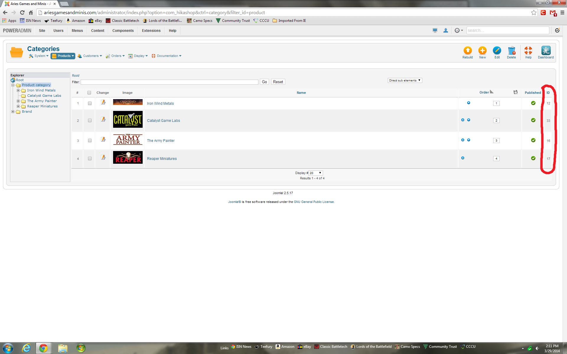

Ok, in the attached image "Search Options", I have the ItemID box circled, this is where to put what you're telling me to right?

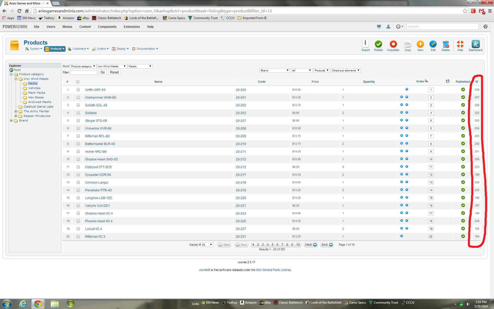

As far as the menu item...is that the ID that is found on the far right of the attached "Product Category ID" image, or the "Product ID" image?

It's none of them. As I said, it's the id of a products listing menu item that you need. So like any menu item, you'll find them in the Joomla menu manager (menu Menus of your backend) and the id of the menu items will be on the right of the menu items listing.

Um, no, it's not.

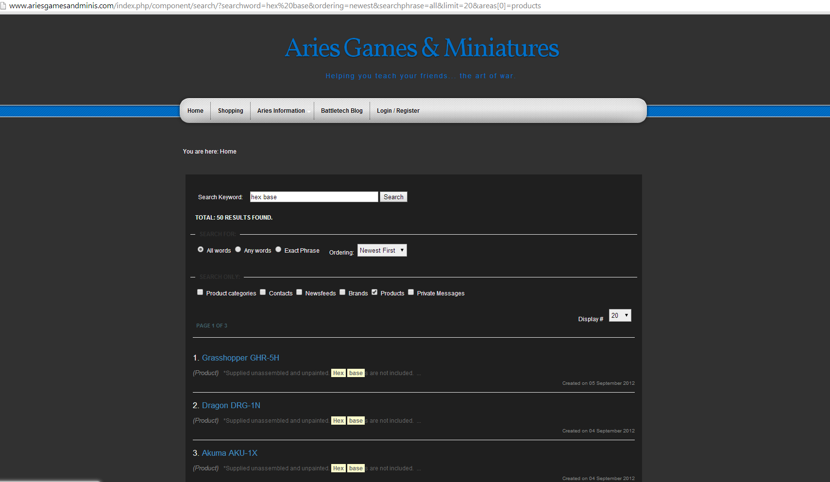

Go to www.ariesgamesandminis.com , click shopping at the top, then scroll down, search for Hex or Hex Base...
In the search results window, there will be a listing for Hex Base, click it, it goes no where.
Where the hex bases are under shopping is the manufacture Iron Wind Metals, then scroll down to Hex Bases, then click the only hex base listing I have...

Nicolas, the above issue was still present. Anytime I searched out "hex base" it would pull back the "category" not the "product". The term "hex base" is also listed in each listing on my site for certain products as the base does not come with that specific item...so that's why the image above shows a listing of "hex base" on each product.
Well, today I got adventurous in trying something. Both the Category and the Product were titled Hex Bases (with the product being titled Hex Bases (4) as that's how the manufacture listed it). Well, I changed the Category to "Bases" and removed the (4) from the product listing...and now the actual product Hex Bases shows up in the search rather than the Category.
