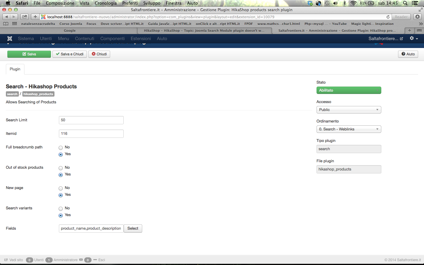

  • Posts: 12
12 years 2 months ago #151925
there you go
12 years 2 months ago #152042
In the itemid field, you have to set a product listing menu id for the product search and a category listing menu id for the category search.
  • Posts: 12
12 years 2 months ago #152045
what do you mean? 116 is already the product id.
