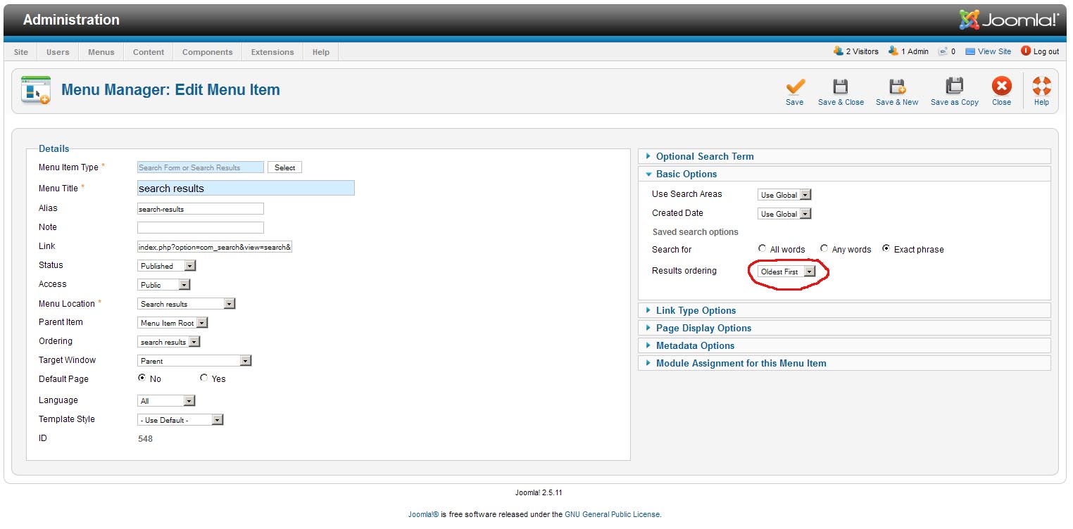

  • Posts: 40
11 years 11 months ago #170198
Here is the screenshot of what I was talking about. As you can see, there are basic options on the side for ordering.
I used this menu item option in order to have the results appear on a separate page. Maybe it only works for Joomla articles?
  • Posts: 86081
  • Thank you received: 14189
11 years 11 months ago #170213
I don't know what this option does. I've tried it on my end and it doesn't change anything.
The ordering is controlled by the user himself on the search page on my end:
take.ms/eKo6i
I see that your search results page is quite different from the default and has apparently been customized in the template. Maybe that's why you don't see the dropdown ?
