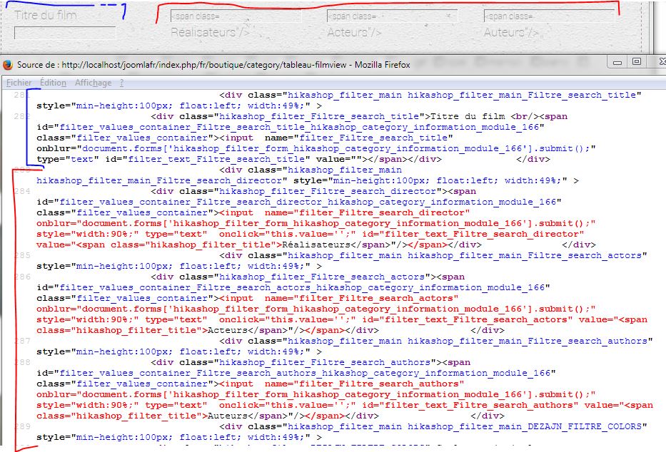

  • Posts: 24
11 years 6 months ago #191684
I changed the code in filter.php
The text is now translated but the results are incorrect (please see the captures images)

  • Posts: 24
11 years 6 months ago #191855
I upadated filter.php with this one .
I deleted and recreated my filters and the translated titles are correctly displayed inside the filters.
But now there is a new problem : the (translated) titles inside the filter are used as search terms when there are multiple filters !
If I don't remove the titles, they get searched. Please see the enclosed picture.
Best regards.
  • Posts: 86081
  • Thank you received: 14189
11 years 6 months ago #191878
Ah, yes, I didn't think of that.
Change the code:
$name=strip_tags($this->trans($filter->filter_name));
$onClick=' onclick="this.value=\'\';"';
to:
$onClick=' placeholder="'.strip_tags($this->trans($filter->filter_name)).'"';
and that should work properly.

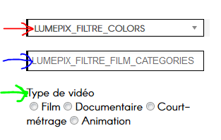

  • Posts: 24
10 years 7 months ago #226106
Since i have updated hikashop to 2.6.0 the translated names of some filters, when the name are "inside", don't work anymore.
In the picture :
- in red : simple list -> not translated
- in blue : multiple list -> not translated
- in green : radio button -> translated
Can you update filter.php ?

  • Posts: 24
10 years 7 months ago #227840
1.
$html.='<OPTION VALUE="none">'.strip_tags($this->trans($filter->filter_name)).'</OPTION>';
-> Now the filter name in the dropdown is translated, but the title inside the filter is still not translated.
2.
Just a note if someone else as this problem : hikashop 2.6.1 already as this code included.
3.
The titles inside the filters are still not translated (please see the enclosed picture).
Can you update the code ?
Best regards.
Last edit: 10 years 7 months ago by dezajn.

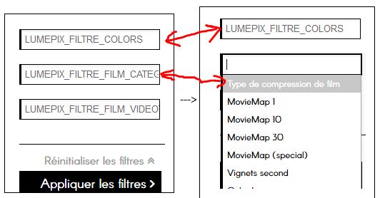

  • Posts: 24
10 years 7 months ago #227999
Sorry, i'll try to explain it in a simpler way.
I have MultipleDropdown filters (with custom fields)
When I clic on the filter the title is translated :
(Here : "Couleur principale")
But when I don't clic on the filter, the title is not translated when positionned inside.
(Here : "LUMEPIX_FILTRE_COLORS")

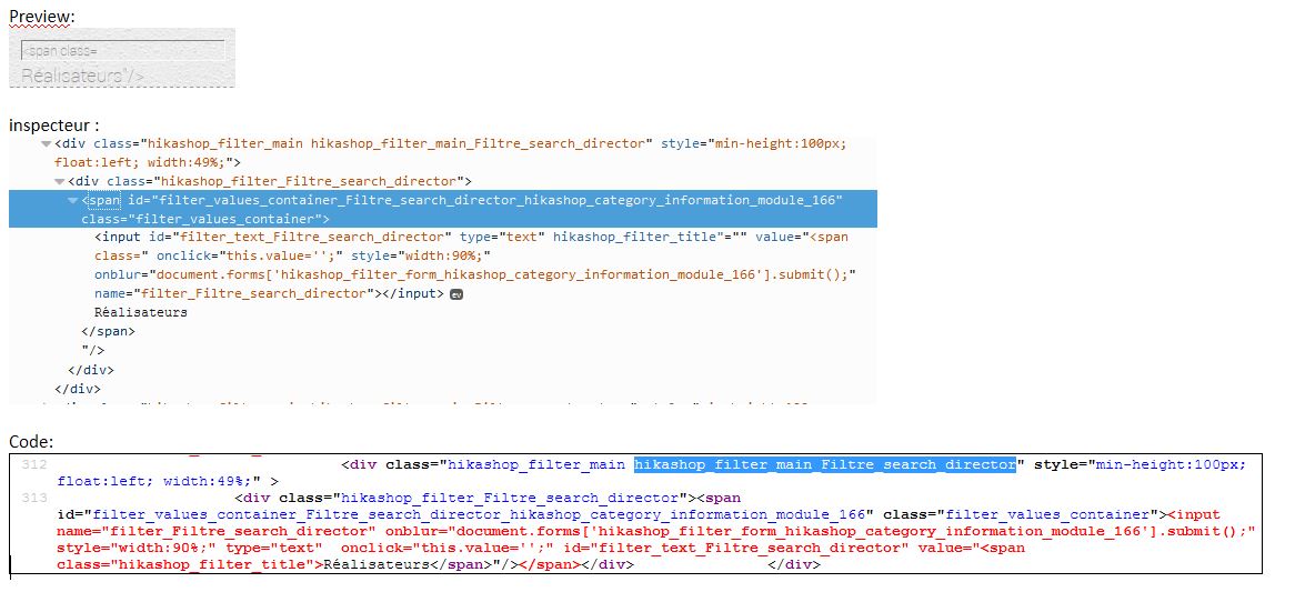

  • Posts: 86081
10 years 6 months ago #228428
We got the access.
So the issue comes from the data-placeholder that is added. I don't know how it's added as we don't have such code in HikaShop.
I'm thinking it must be added by something else on your website: take.ms/xJXZE
Also, if you turn off the "use chosen library" setting of the HikaShop configuration, it should hopefully avoid the problem, but I couldn't test as the user account you provided doesn't have access to the HikaShop configuration.
