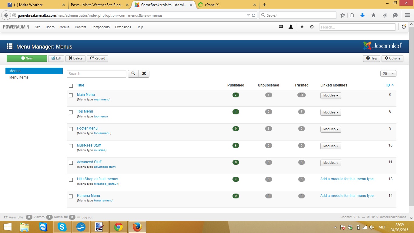

  • Posts: 67
11 years 5 months ago #193178
thanks but not quite understanding. Is it any of these (see attached)?
11 years 5 months ago #193182
Please forget about the "Itemid", it is useful only when the search is working and if you want to provide some specific links to the products/categories.
You can leave the field blank without any trouble...
