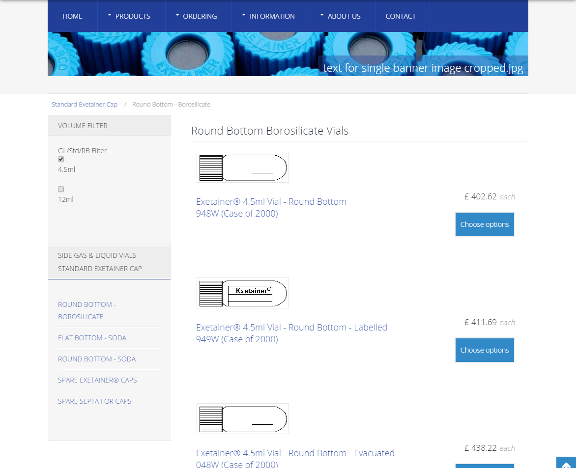

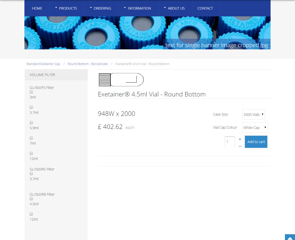

I have created 3 filters (all apply on category) set up which are displaying in a module filter. They all work correctly on the category listing, 1 correct filter is shown for each category. But when you click through to the individual product page then all 3 filters are displayed in the filter module. I've played around with the filter and module settings but can't work out how to turn off the filter module for the individual product or at the very least only show 1 filter and not all 3.
I've attached screenprints of the pages, the website is behind a password which I'll pm to you.
11 years 3 months ago #201644
The module is associated to the product listing menu, but this same menu is used when clicking on a product to reach the product page, so we display the modules associated to the product listing menu too on that page.
You will have to use the third extension "Advanced module manager".
This allow to manage more precisely the module display.
