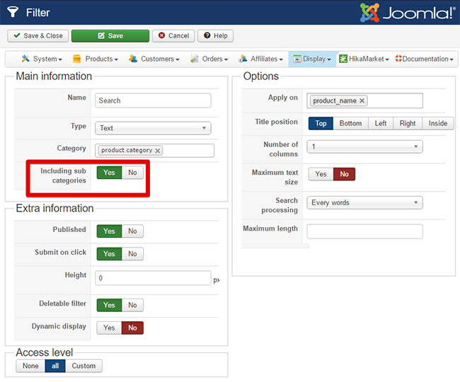

i have a lot of subcategories or nested subcategories.
example
footwear
> shoes
>> leather shoes
>> non leather shoes
if i have a product and place it under shoes category the search cant find it. i have to select shoes and product category for the search to find it. is this normal?

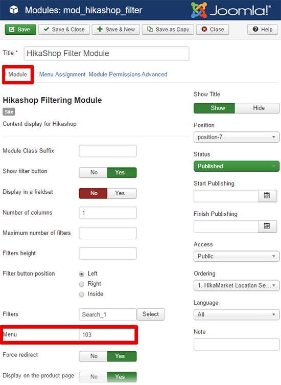

10 years 2 months ago #244057
Can you check your "Including sub categories" option in your Filter Configuration ?
Second step to check, in your HikaShop filter module, in Extensions => Modules, click to edit your HikaShop Filter Module, look for Menu option, do you have like this screenshot example, if you have the menu item id in order to your filter look IN this item menu.
If this option is already setted on "Yes", there is something strange and so, the best way to progress will be to send us back end references via our Contact us form, just add an Url link to this topic.
Awaiting news from you.
