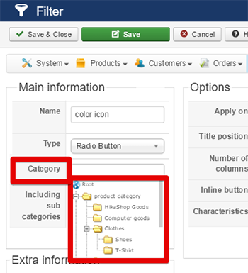

See, the Category that will limited the search only in this specific category.

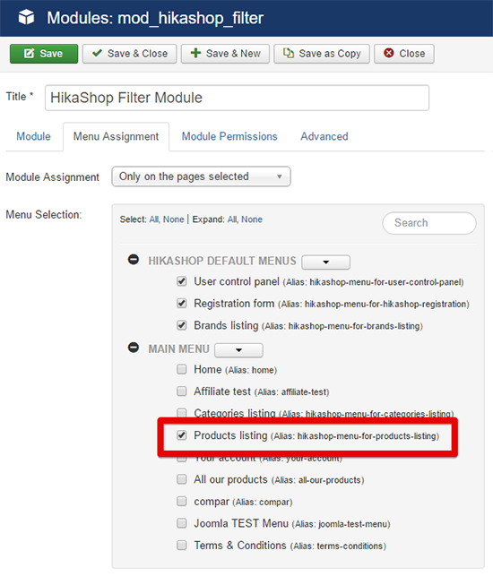

Second step, Use a module with Menu Assignment like on this screenshot and select your required Filter:
And so here, this module will only display ONLY on the required products listing.
You have just to repeat this kind of configuratoion for each listing.

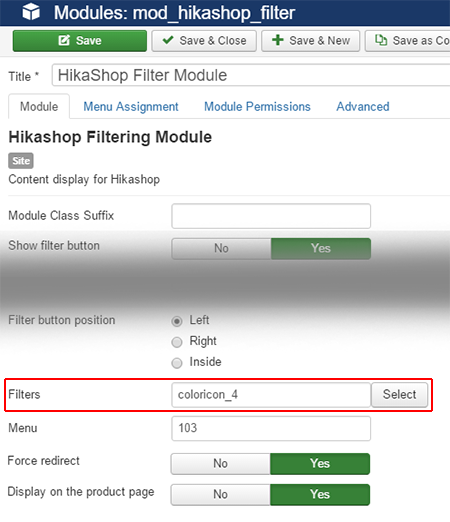

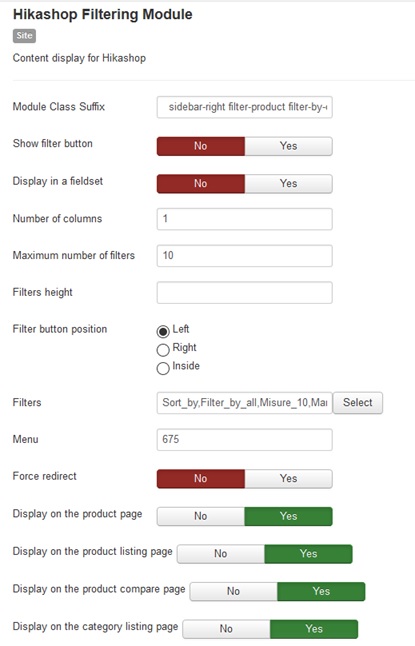

This is my site configuration:
- IMAGE 1: my HIKASHOP filter module configuration. I set the MENU parameter with the menu id where is possible to see the filter

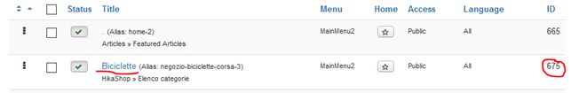

- IMAGE 2: the menu item where is shown the filter module, on the left side of the page. In this page, is possible to see the product of category BICICLETTE
- I associated the characteristic COLORE to this product category

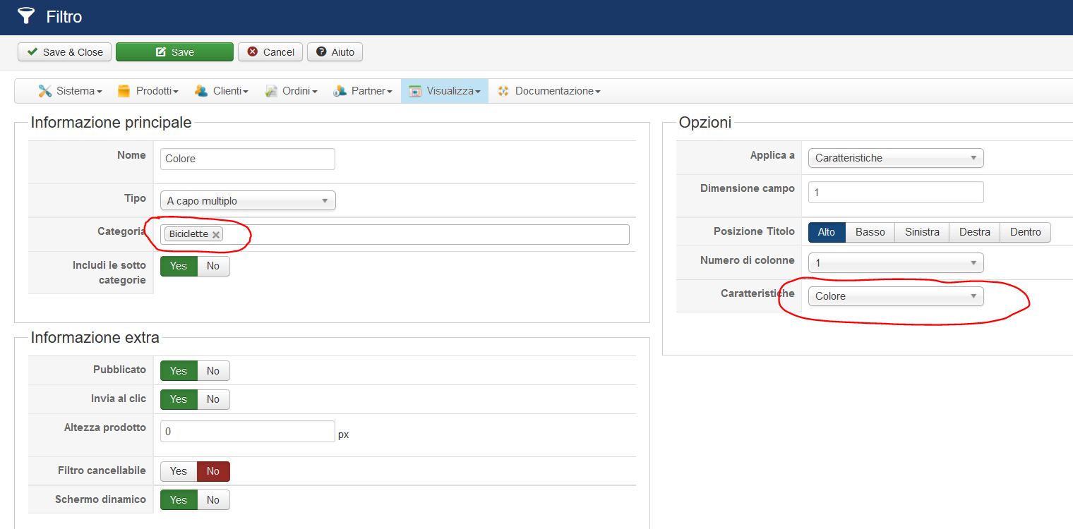

- IMAGE 3: the filter configuration. I create a filter called COLORE (=color in english); I set the category BICICLETTE, the same of the menu; the characteristic associated is COLORE (parameter on the right of the image), I included the subcategory;

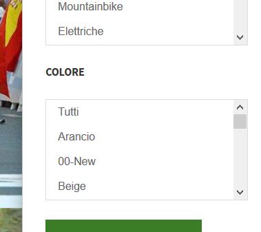

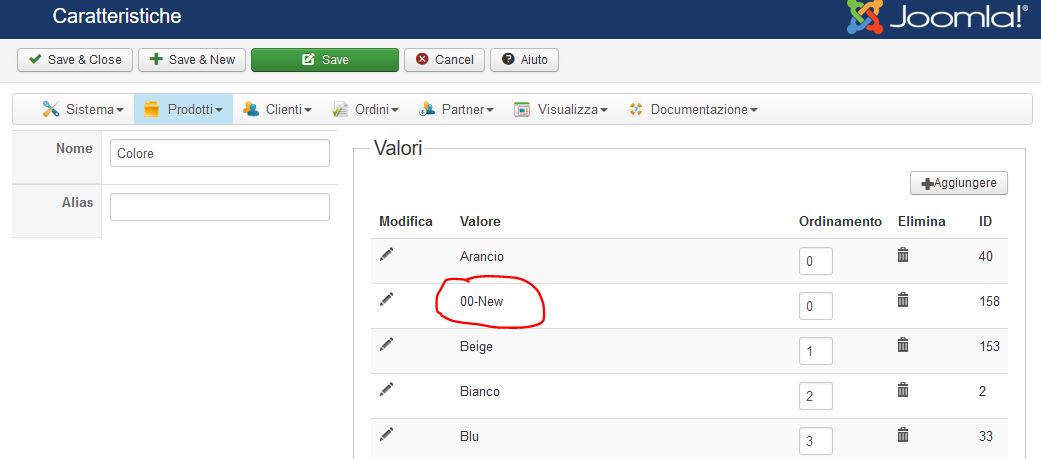

- IMAGE 4: the characteristic COLORE, where is possible to see the test value 00-NEW

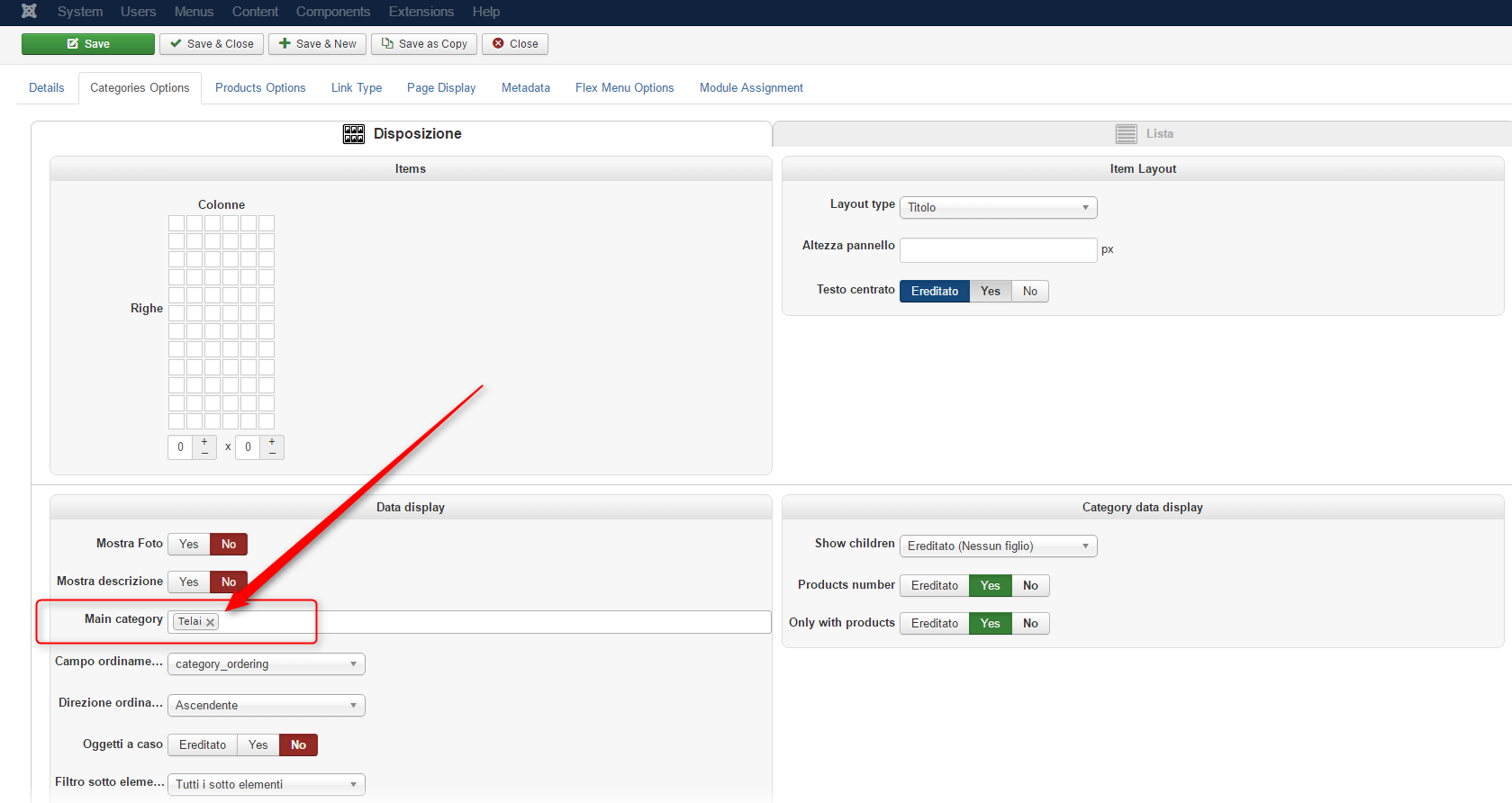

- IMAGE 5: the hikashop filter, that doesn't limit the list with only filters value associated with one product at least. You can see the value 00-NEW, that it doesn't associated to any product.
Where's the problem?

The issue is that you customized the "filter" file of the view "product" and commented out the line:
$datas=$this->filterClass->getProductList($this, $filters);
It's this line which allows the filters system to activate the "dynamic display" of the filters and display only the values used in the products of the listing. If you uncomment that line, it will display like it should.

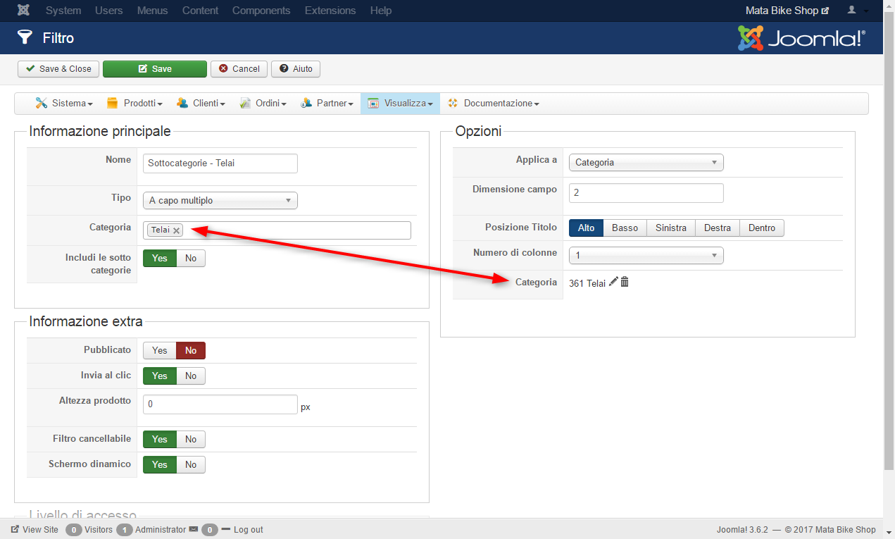

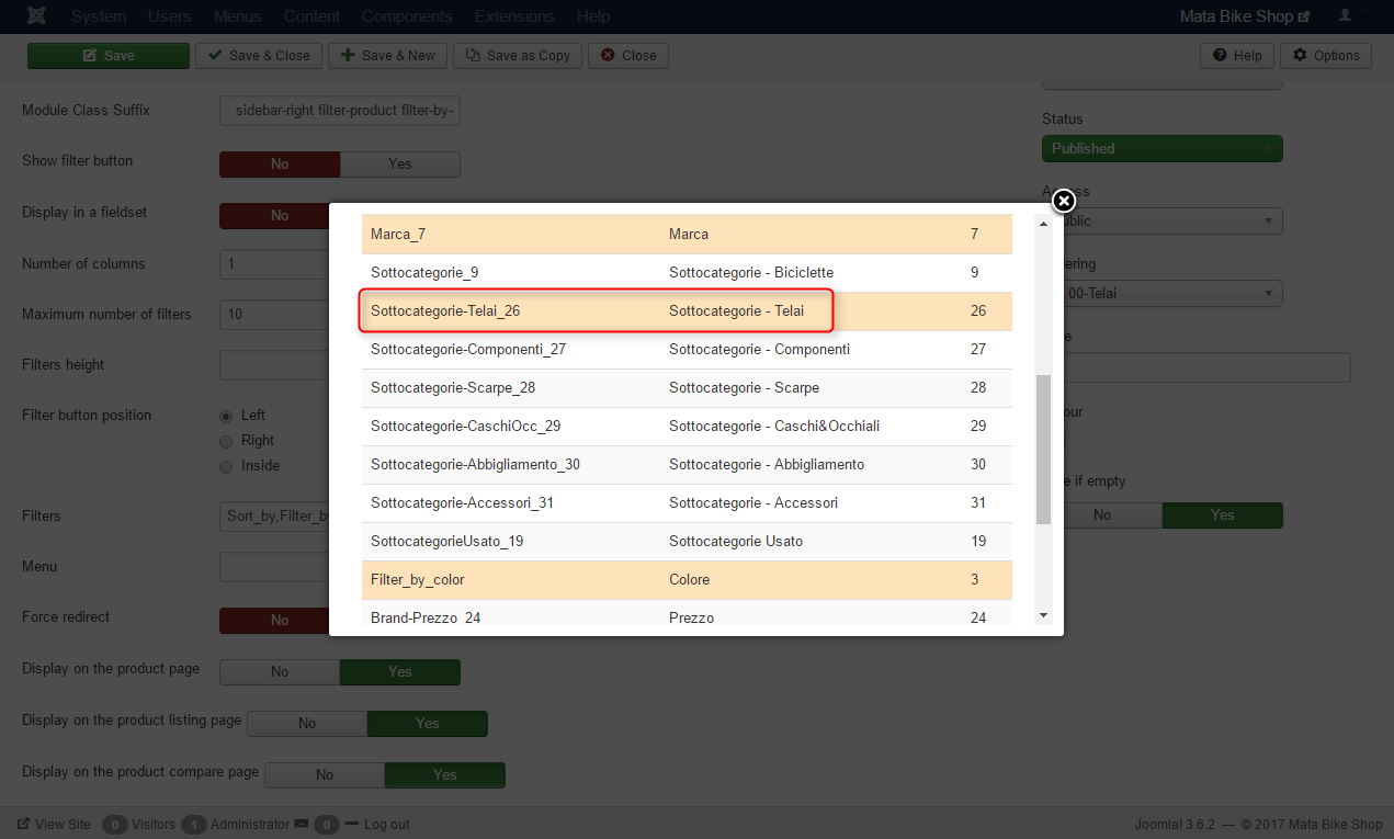

I attached three images:
- one about the filter configuration, where you can see where I selected TELAI category;
- one about the selection filter into module filter.
- one about the category menu
The filter configuration is correct?
Considers that I would create ONE filter for every category menu; for this reason, into filter configuration, I selected the main category. I expect to see, in the filter, the list of subcategory of the corresponding category menu page.
Really thank you for the support.
BR
MatteoS
Last edit: 9 years 5 months ago by simtheo.
  • Posts: 86081
  • Thank you received: 14189
9 years 5 months ago #264282
The settings look fine.
