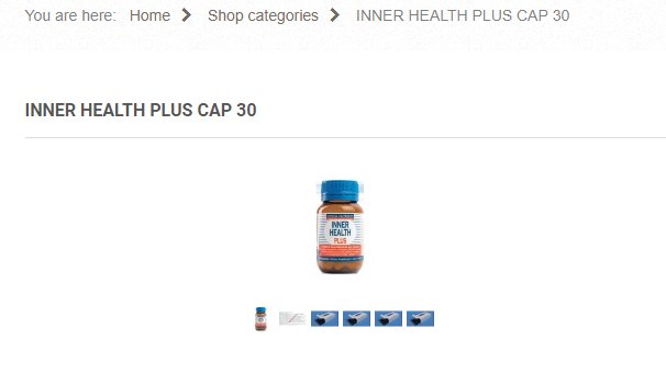

apologies if this has been asked/answered elsewhere. I couldn't find anything..
After a successful search my breadcrumbs just show the top level category title and the product name. Is this the standard behaviour? I'd like for end users to be able to drill back up and look at more of the same.
Thanks,
Ian and Stu
Last edit: 9 years 2 months ago by smithshop123. Reason: add in picture

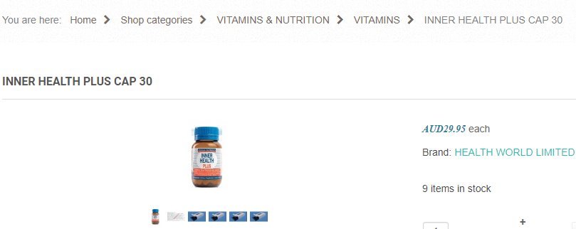

9 years 2 months ago #272916
this worked really well. For anyone else doing the same thing I did;
  • Looked under: Configuration > Features > SEF url options
  • Simple breadcrumbs: OFF
  • Use canonical URL and generate if missing
  • Alias automatic filling: YES (not necessary but didn't hurt.
An updated image is attached showing the same product after a search.
Thanks,
Ian and Stu
