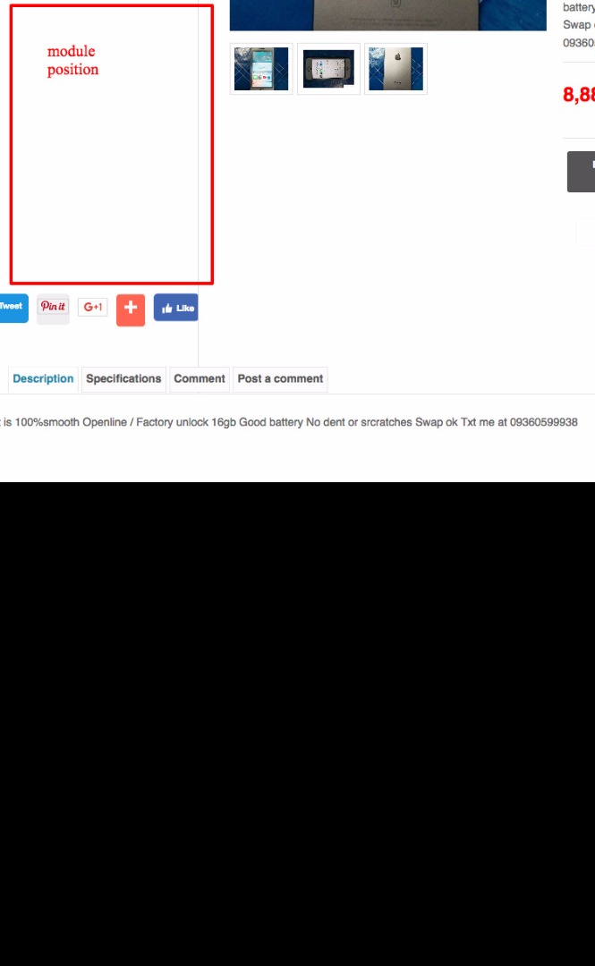

I set the filter to only appear on the main menu and its sub categories. I also set the module to "Display on the product listing page = yes
" and "Display on the product page = no". Product listing is ok but on the product page it is not showing but i have a white space on its position. how do i solve this?

  • Posts: 490
9 years 1 month ago #273661
hi again
sorry i forgot to add the screenshot. i attached it below.
it is the module position sidebar 1 in my template. i think joomla thinks that module position is not empty so a white space is being allocated for the module.
BTW i am using advance module manager and i already set "hide if enabled = Yes"
  • Posts: 86080
  • Thank you received: 14188
9 years 1 month ago #273663
This has nothing to do with HikaShop or Advanced module manager.
It's your template which doesn't handle empty module positions :
www.regularlabs.com/forum/advancedmodule...mpty-area-on-sidebar
