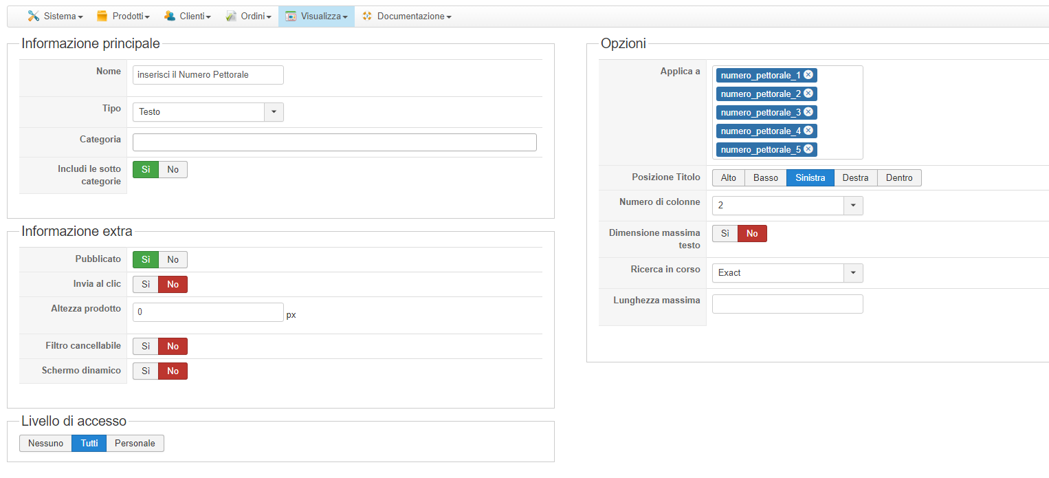

Hello
I have a problem with the search field for a filter, i load the images rated with the number 0 but when i put in the search number field 0 I will see all the images containing one 0. if i insert 104 works and only finds 104 but if i I put 0 i find all 0 but also 10, 104, 1000 etc.
It seems that number 0 does not recognize it as a numeric value

The problem is exactly what is already set to exact, I have tried other parameters but the result does not change
  • Posts: 85860
  • Thank you received: 14101
8 years 11 months ago #275292
Thanks for the screenshot and the additional details.
