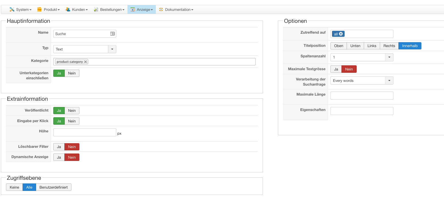

  • Posts: 17
8 years 6 months ago #288657
thanks for reply.
That's what I thought. I've already tried it, but there was no change.
Now I have tried again. It still does not work as it should. What do I overlook? Do you have a clue?
Thanks,
Nicole

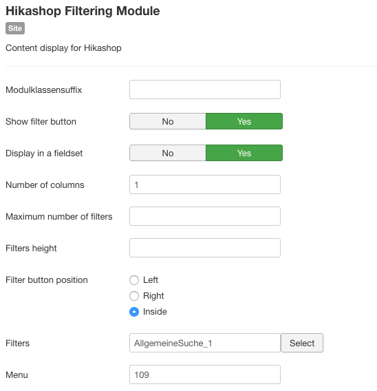

I went and looked againt at the situation on your website.
You need to configure the filter module so that the button is displayed inside the form and not outside. There is a setting for that there.
Otherwise, if the button is outside, it won't be seen by the form.

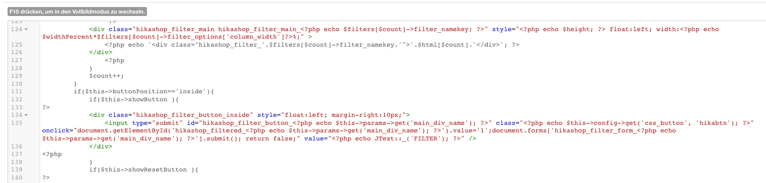

The second thing is that, contrary to the demo website, you're using the new buttons system of HikaShop 3. And it uses a tags instead of input tags. And thus even though they looked like buttons, they aren't real buttons.
You'll have to edit the file "filter" of the view "product" via the menu Display>Views and change the lines:
<a href="#" id="hikashop_filter_button_<?php echo $this->params->get('main_div_name'); ?>" class="<?php echo $this->config->get('css_button', 'hikabtn'); ?>" onclick="document.getElementById('hikashop_filtered_<?php echo $this->params->get('main_div_name'); ?>').value='1';document.forms['hikashop_filter_form_<?php echo $this->params->get('main_div_name'); ?>'].submit(); return false;"><?php echo JText::_('FILTER'); ?></a>
to:
<input type="submit" id="hikashop_filter_button_<?php echo $this->params->get('main_div_name'); ?>" class="<?php echo $this->config->get('css_button', 'hikabtn'); ?>" onclick="document.getElementById('hikashop_filtered_<?php echo $this->params->get('main_div_name'); ?>').value='1';document.forms['hikashop_filter_form_<?php echo $this->params->get('main_div_name'); ?>'].submit(); return false;" value="<?php echo JText::_('FILTER'); ?>" />
Then it will work fine.
  • Posts: 17
8 years 6 months ago #288694
sorry, but it does not work. The button is inside and the code is changed.
Did I forgot something?
Thanks,
Nicole
