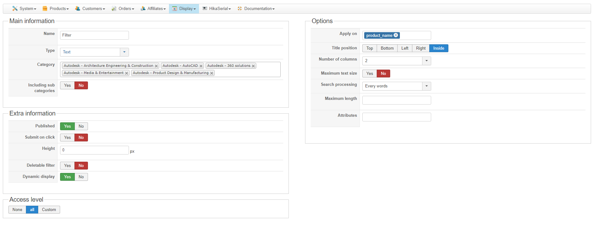

Currently the filter applied to my store is limited for searching product in that particular category only. Joomla's search module is not an ideal one as the result are not shown in images with product info. I would like to have a product-wide filter, which means i can search across different categories.
Enclosed please find the current setting out the filter. Many thanks!

I suppose that you're displaying the filter through the HikaShop filter module.
You need to edit the settings of that module via the Joomla modules manager and activate the "force redirect" setting there and make sure that the id you have in the menu item id setting is for a menu item of the type HikaShop products listing configured to display all the products of HikaShop. That way, when you use the filters of that filter module, it will display the products listing of that menu item and filter them based on what you entered in the filters of the module.
