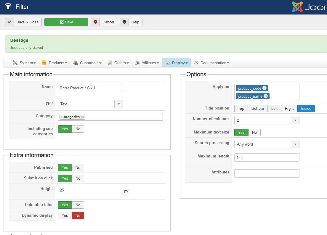

Hello, I'm having issues with my search. I've configured it to search on the product name and sku, but when I cut n paste the full product name into my search bar, it finds nothing. I also can't get the product code search to work either. It does return basic search results i.e. if I type in part of the product name - very odd!
I've attached my config screens

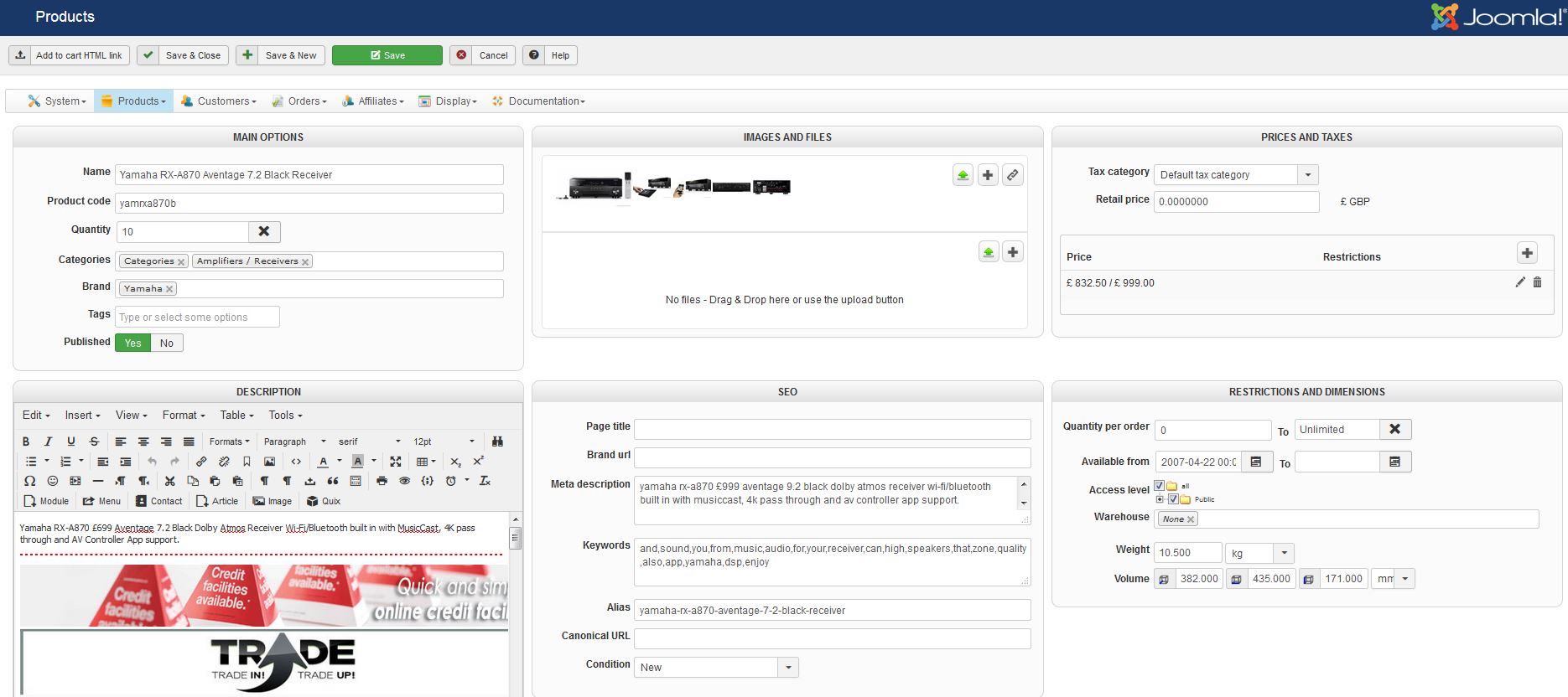

Here's an example ... Yamaha RX-A870 Aventage 7.2 Black Receiver returns a page of assorted products including other yamaha products but not the one I searched for?
Here's the config for that product.I thought it might be the canonical urls as I changed the menu heading recently but none of my products have them.

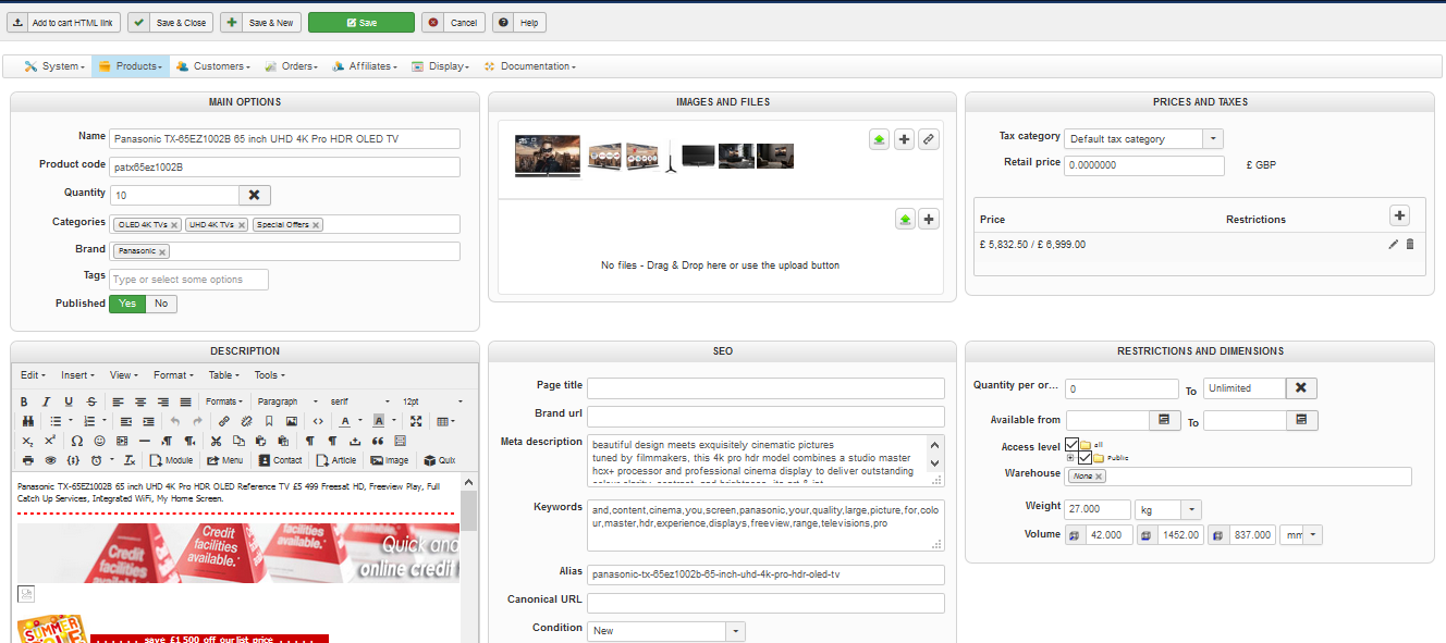

OK, I've changed the setting to 'every words' but I still can't get some products to return results - try searching for Panasonic TX-65EZ1002B 65 inch UHD 4K Pro HDR OLED TV.
Here is the config for that product;
