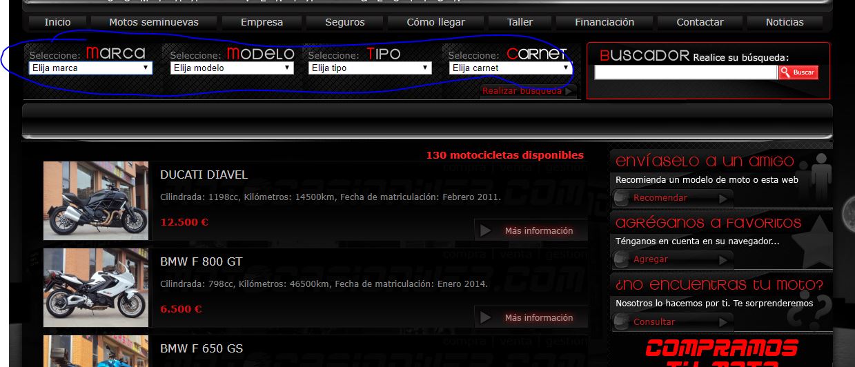

Hello! I just installed hikashop business to do some filters for my website. I want to make some filters like the ones that appear here:
They are for a website of motorcycles, I want that when you enter a product you fill in some personalized fields of "brand", "model", "type", "carnet" and search for each one of the filters or for all of them at the same time. The problem is that I do not know how to do it. If someone can help me I would appreciate it.

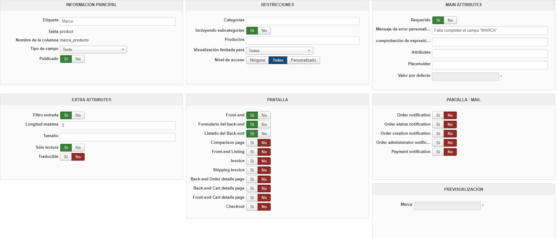

7 years 9 months ago #300233
It's probably because of the type of your custom fields and the fact that you didn't enter the values in the custom fields. They should be of a type like radio, or checkbox, or single dropdown, or multiple dropdown, but not "text" or "text area".
Could you provide screenshots of the settings of your custom fields ?

This is how I want them to show:
This is how I configured the custom field "brand" ("marca" in spanish):

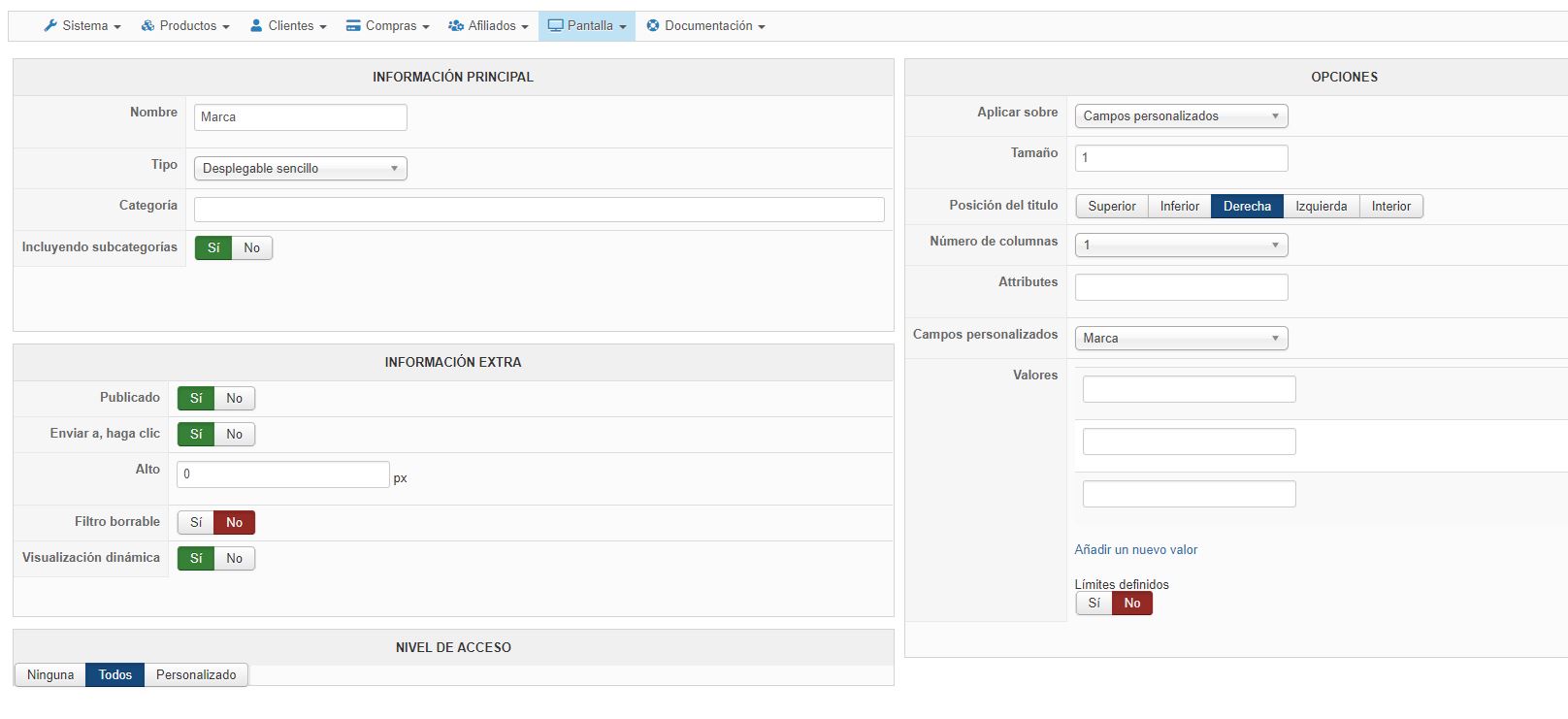

And this is how I configured the filter "brand":

  • Posts: 86080
  • Thank you received: 14188
7 years 9 months ago #300280
You won't be able to do what you want with filters of the type "text". You first need to change the type of the custom field and enter all the possible values in the custom field, as I said previously. Then, you can select the value you want in each product.
