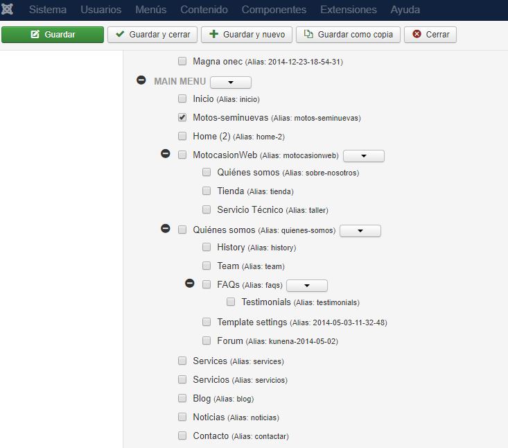

  • Posts: 41
7 years 6 months ago #303361
Hi! I only have the option to select the page of the products list at Joomla. Obviously the product pages are not shown.
I attach a capture of the menu assignment were you can see the prodcut list page "Motos seminuevas" selected.

  • Posts: 86080
  • Thank you received: 14188
7 years 6 months ago #303364
In the menu assignment tab, you can only select menu items, indeed.
However, in the main parameters of the module, you have display settings to select whether or not to display the module on the product pages of the menu items on which the module is assigned, and similar display options for other types of HikaShop pages (checkout, listings, etc).

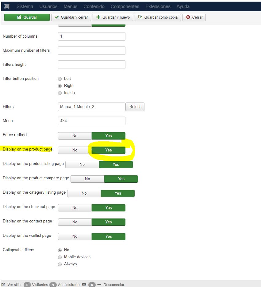

  • Posts: 41
7 years 6 months ago #303449
Hi! it's right. I have this option selected but doesn't work. Do you know why this happen?
I attach the capture of the selected option.

  • Posts: 86080
7 years 6 months ago #303451
Make sure that the module is assigned to the menu "motos-seminuevas" and to a valid position of your template and that its access is public.
Make also sure that the two filter that you selected in it are published in the Display>Filters menu.
Besides these I don't see anything else which could make the filter module not display on that page.
