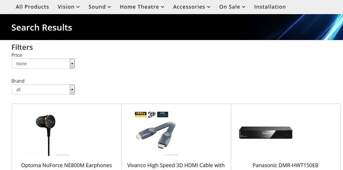

Hi Nicolas, I couldn't get it to work no matter so I ended up replacing both the filter.php and listings.php files extracted from the lasted Hikashop download.
This has fixed everything, but I can't help wonder why the original files were dated 2018 - it suggests they weren't updated in the last update?
Also, is there a way to show the filters across the page rather than stacked on top of each other?
  • Posts: 85860
  • Thank you received: 14101
6 years 9 months ago #311050
If the files have permissions which don't allow the update system to update them, then it won't update them.
This might have been done by the person who customized them instead of doing it through view overrides so that they could directly edit the view files while not loosing the changes after each update (which the view overrides prevent by having a copy of the view file in the template which has priority over the main view file).
Regarding the stacking of the filters, in each filter you can select the number of columns of the filter, and in the HikaShop configuration, in the Filters section, you have a setting to define the number of columns of the filters area. So if you set that area to have 3 columns, and if each filter is set to use 1 column, you'll have three filters per line.
