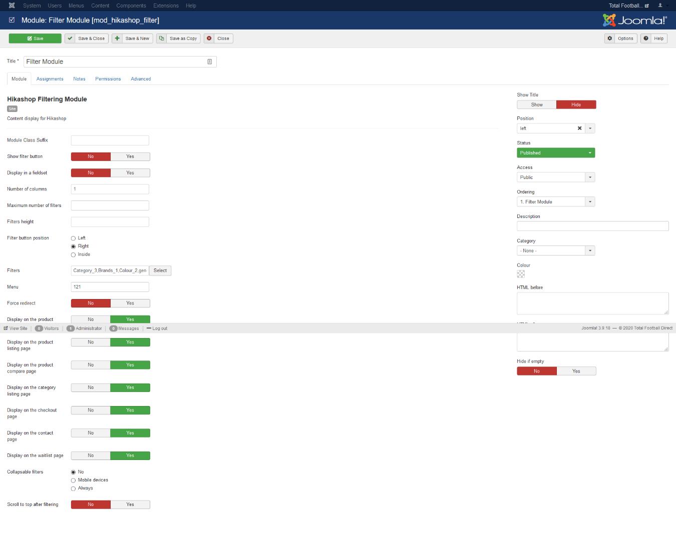

We have process some tests in order to better understand the situation and try to get the root issue, so far I see that you have strange behavior of your module filter, maybe link to javascript error ?
In order to going more far can you :
- Process some tests with a default template (like ProtoStar)
- Provide all your filter relative settings via screenshots

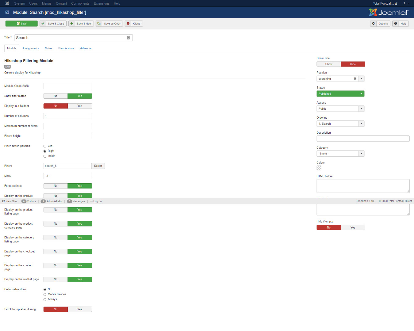

6 years 3 months ago #318706
Ok It seems the issue is SEF and then the fact there is two filters on one page.
If I turn the search filter at the top of the page off the side filter works.
Its the same for other templates.
Please help :)

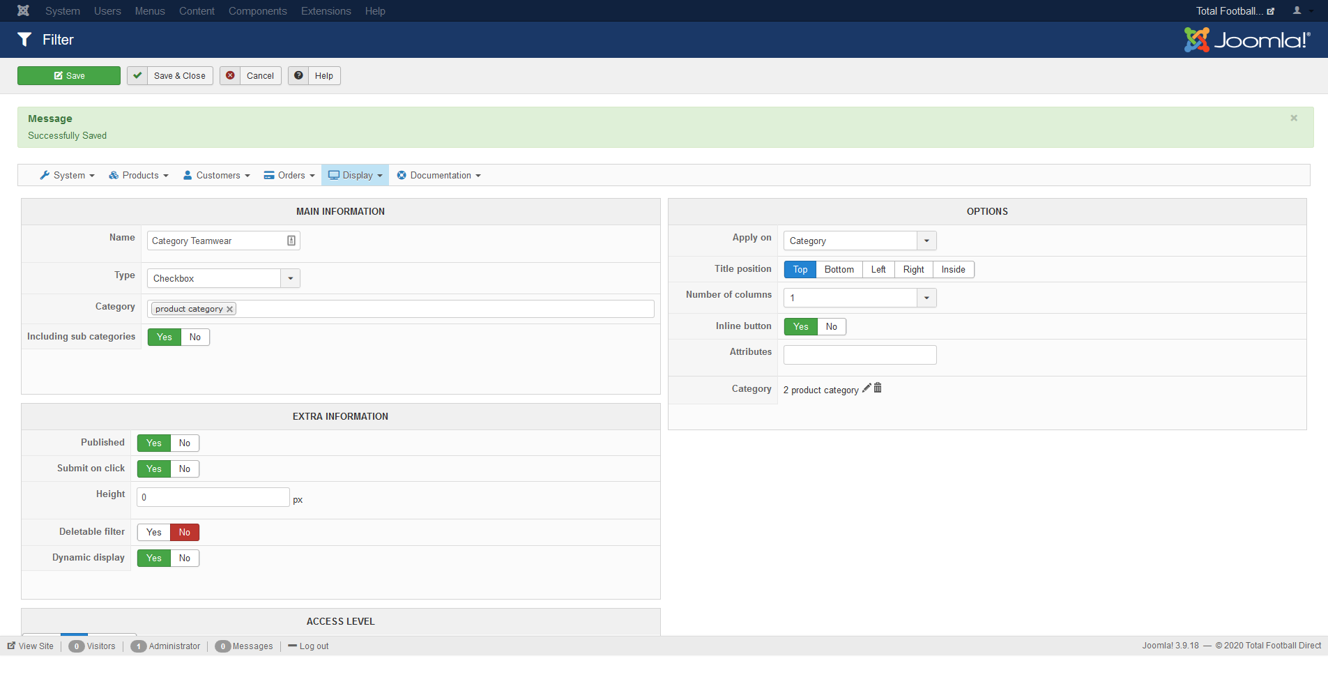

I have another issue. Plese see setting for category filter attached.
if setup was
Cat 1
Sub cat 1
Sub cat 2
Cat 2
Sub cat 1
Then we navigated to Cat 1 I would expect Sub cat 1 and 2 to display in the filter? This is not happening - I can't even describe what its showing its odd.
Do I have the settings wrong? How would I achieve this?
6 years 3 months ago #318927
I think you filter information were not properly used.
The "Category" option from the "Main information" tab is used to only display this filter field on pages of that category, and the "Including sub categories" option is used to also display it on these sub categories.
The "Category" option from the "Options" tab is used to control which categories to display.
Kind regards,
Mohamed.
