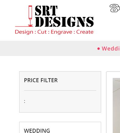

I was creating some new products when I noticed the Price Filter which usually shows £0 - £20 with a green bar between the prices has disappeared. It worked fine before and the only thing I can think is the latest version of Joomla has been installed since last checked. Any ideas?

I think it comes from the javascript error you have on the page:
monosnap.com/file/BWiLAcWNs96u1pedlDu6vnoJVVokN6
That stops the browser from running the rest of the javascript code on the page, including the bit to initialize the filter selector.

If you check the javascript code for the cursor filter on the page, you can see this:
i.imgur.com/obpjdH7.png
As you can see there, between the parameter name and the parameter value, the ":" is missing for all the parameters.
So for example, instead of:
step 1
you should have:
step: 1
This comes from the code:
$params.="\r\n".$key.': '.$option.',';
in the file administrator/components/com_hikashop/classes/filter.php
So either that code was modified to remove the ":" (which is highly unlikely, or there is something processing the HTML/JS code on the page and stripping out the ":" from there.
Now, if I look at the source of the page with my browser, I do see the ":" there:
i.imgur.com/sliw8T5.png
So that means that it's some javascript loaded on the page which modifies the javascript of HikaShop before it is run and breaks it.
Now, if I look at your template's JS file: bmcpharm.com.au/templates/r_shopin/js/template.min.js?6046cdc9
I see this at the end:
$('#g-sidebar div.hikashop_filter_main').html(function(i, html) {
        return html.replace(/\:/g,'');
i.imgur.com/pxHsHe4.png
This code is made specifically to remove the ":" from the filter area of HikaShop and thus breaks the javascript code there...
