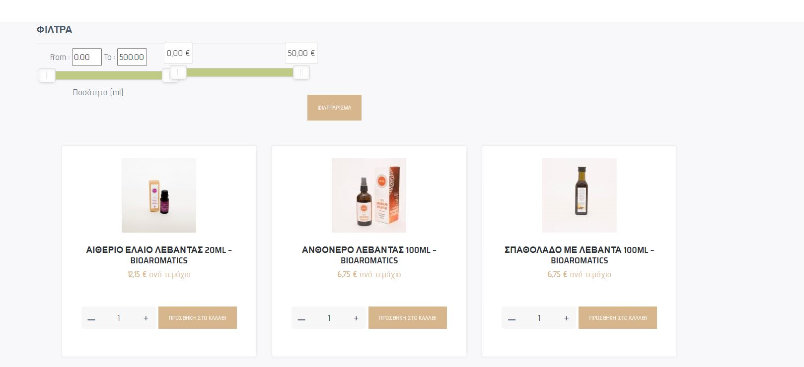

I use the New Age Package of Jollyany Template.
I have a problem with the declaration and appearance of the filters! I want to have three or more filters and as soon as I create them, they automatically appear at the top of the page! I created a left section(part) and state there a module that I have created but the filter does not show me! so that I have my filters to the left of the products one below the other;
also when I added the left part the products have a different size than before.

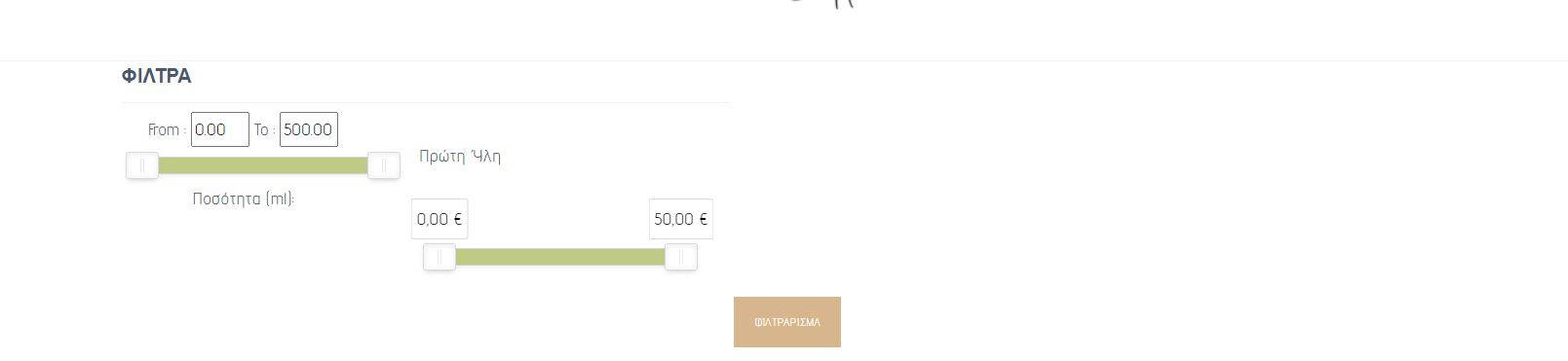

So first, if you don't want the filters at the top of the products listing but on a sidebar area, you want to turn off the "Filters" display setting under the "products options" tab of the settings page of your menu item:
i.imgur.com/BaAjOg2.png
That will remove the filters from the top. And you add them on the sidebar, you want to configure the "HikaShop Filter module" to display on the sidebar position of your template, and make sure that the "force redirect" setting is turned off and that the "display products listing" setting is activated.
I've done the modifications for you and here is the result:
i.imgur.com/RLn6hDz.png
Now, instead of one filter per module and three modules, I would rather recomend to have only one filter module with the three filters selected in it. It should work better and display nicer.
